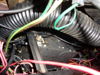

Thanks bee. I see the bracket but it doesn't seem to line up with the bolt. I'll try to post a pic.
Any comment on the bezel plate. Does the radio attach to the plastic bezel with the knob nuts?
What year? Usually the radio bolts to the dash frame, and the finish plate screws to the dash. The knobs on 70 and later just push on the shafts, and the 69 and earlier are thumbwheels.

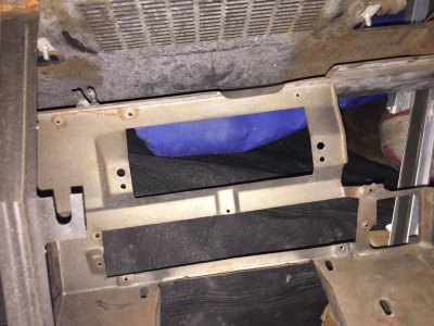

This is the backside of the dash frame
You could be missing an additional bracket with a hole and stud to reach the dash brace.
No bend at all. Now that you mention it, this was a factory 8 track car. They had a different dash?
