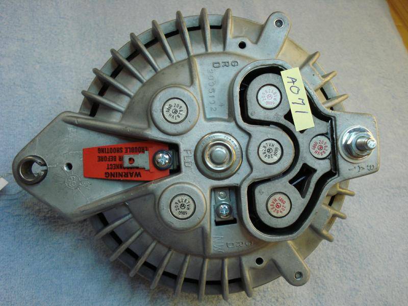

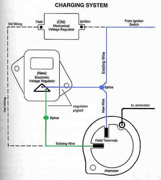

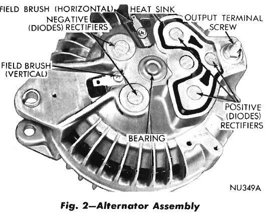

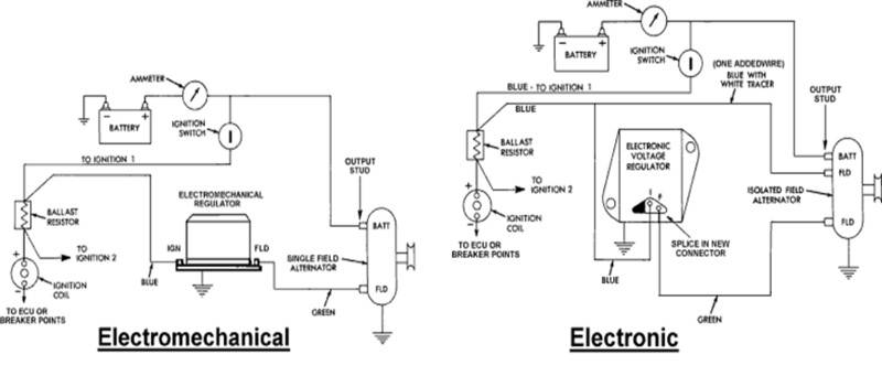

Generally, electronic regulators are more accurate/reliable than their mechanical counterparts. There are direct replacement electronic versions on the market for the pre-’70 applications. The square-back alternators were designed for the 1970 and later factory electronic regulation, have two field connections “isolated” from the alternator case. They can be modified for use with pre-70 regulators and there is significant benefit to running the later higher output alternators, more charge current available at idle.
