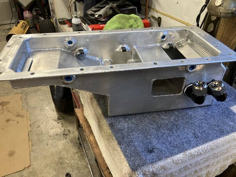

New to using an oil pan without provisions for dip stick. At what point on the inside of this oil pan is oil level full.
Thanks in advanced, Larry

if all else fails , you could measure qts of water and figure out the level compared to the crankshaft , so as not to interfere /or being overfull. on the bench of course ...
I believe on a factory OEM oil pan, the "full" mark on the indicator falls near the top lip of the oil pan. So in theory, if you measure how much water it takes to fill your oil pan to the top, you'll have a good idea of it's capacity.
That said, I've heard some say the purpose of the deeper oil pans is not to hold more oil, per se, but designed to move the full level further down and away from the crank shaft. Doing so allows you to run more oil without a windage problem. So it's hard to say if you still want to run it with the oil level at the top of the oil pan.

Ask Charlies what the oil pan capacity is. Install pan, put quoted oil amount in engine, and adjust dipstick tube length until the "Full" mark matches oil level in pan.

In a every day street/strip type car a pan without a dipstick would not be preferred. For an all out race engine it will be fine as long as you don't have any leaks. I don't have one in my Hemi street/strip car. However, I am also running a vacuum pump.
Most likely 7 to 8 quarts. mine was a dragster style and it took 10. Figure how much and use water. Fill the pan to the desired level and mark it. Then buy a sight eye.

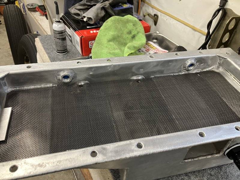

I would still use a windage tray too, measure to below where the tray sit
keep it like 1/4" away/below or more from the tray keep it out of oil

I have a windage screen in the pan as well, and the level is below that.

You can add a dipstick to that pan. Weld in another bung and use a 3/8" compression street 90 x (male pipe thread)-screw into bung and mark a dipstick at your desired level.

I run this same pan. The level ends up being pretty close to the top of the tie rod tube. The factory dipstick will not measure correctly. Even if you modify the pan the stick just bends as it hits the front of the pan. Mine has a boss welded in on the right side kickout of the pan. The pan was filled with 6,7,8,9, quarts of water and the stick calibrated for each level. It takes about 10 qts to get the pan at 8 qts. It's been run as low as 6 1/2 qts in the pan with no issue.

The image of the windage screen in place looks like a strong indicator of where the "full" level should be.
That was my thoughts that it should be a little below the screen which puts it pretty much close to the top of the tie rod tube like Doug stated. This pan does not have the kick out for extra capacity like Doug’s has.
