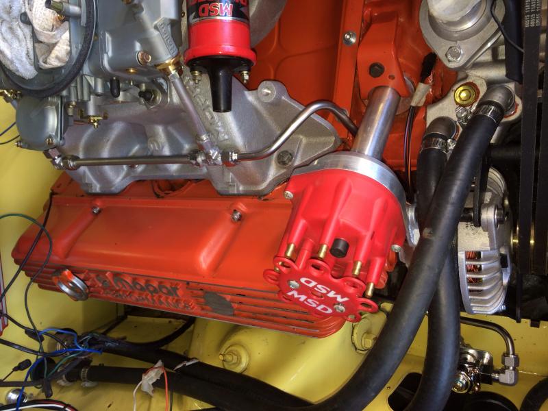

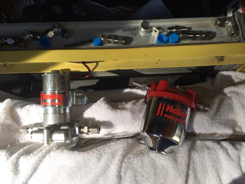

Something's just work out, just the way you been Thinkin what y'all think about my new fuel line. I made it from s/s 3/8 tubing. Got from work. Welded a smoker for trade in left over tubing. And fittins here and there over the last 6 months. The pressure regular fuel IN (bottom) and two fuel OUT (sides) we'll I have one of the outs plugged ? Can I install fuel gauge here? Now I'm goint under to take and install pump and filter, is my filter. Big anuff ? image.jpg

Not concerned about stress put on the lines from the motor torquing against the motor mounts? I always assume there is a little movement of the motor, even if the mounts are new and I would worry you might get a stress crack in the line where it goes into the fitting at the pump.
Otherwise it looks fantastic.

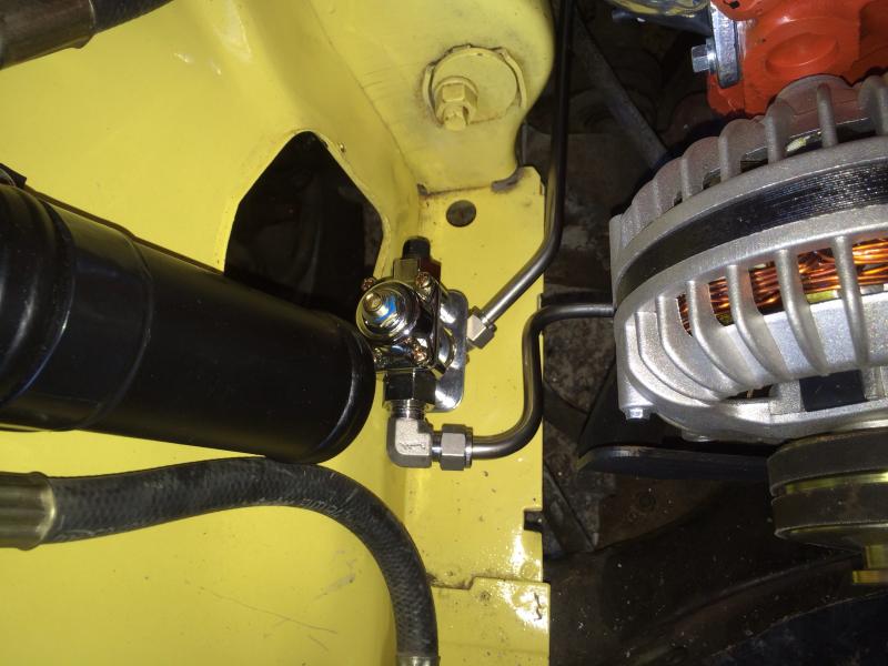

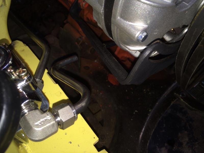

image.jpgIv got about 4 inch place wher Iv got rubber hose Iv just turned the line coming from regular to get it straight. then rubber then back to s/s about where the old mech fuel pump went . That should work right?

Looks good, I couldn't see the soft line section in the pics... Nice work.
Thanks havnt put soft line on yet , like to have steel braded hose, iv got rubber hose guess ill use that , want have to spend money or start me lying

When you put that rubber line in the gap, put a loop in it or at least a wiggle; you'll need the length to allow for movement. Things will move more than you think.
As for a pressure gauge, realize that they tend to be good places to break and spew gas all over. As a race tech inspector, I make people remove them any time I find them. If you can, install a tee, with a fitting where you can connect it in anytime you need to check pressure.
Thanks I was kinda thinkin about a loop in the hose,, I didnt know about presser gauges braking , I was draining gas to do the fuel line , it had rubber hose on end so I just cut hose and started putting gas in can,, well everytime I replaced gas can , to refill , ect,,,,I would spill a little,, I got to thinkin this is good place for fire ,, didnt even have a fire extinguisher, ,so got me one for shop next day ,,,better to be safe than sorry,,
