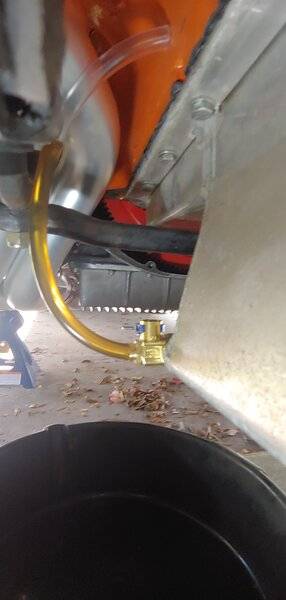

I came up with this configuration to check the oil without a dipstick. To remove the tube, a pair of pliers pinches off the bottom of the tube and then the oil from the tube is put back into the motor. As a plus, the Fumoto valve makes draining the oil a whole lot easier as well.

Conceptually this is an interesting idea.
