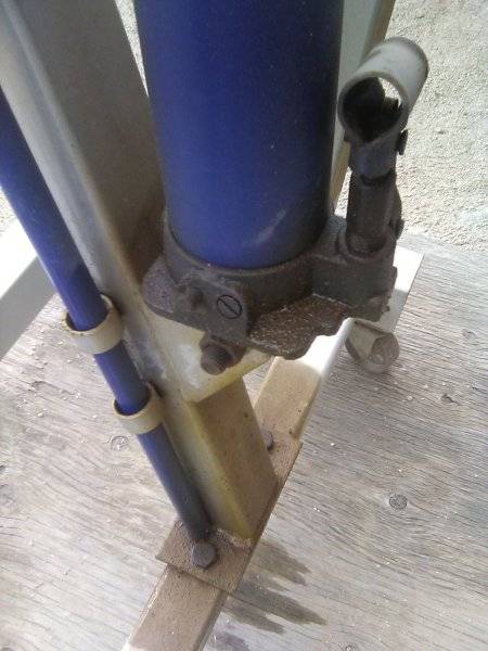

I bought mine up here At the Canadian HF Princess Auto. Got it way back in 2000. Never had a problem with it yet. It's a older/better model than the ones they sell now. Note the out riggers for better stability. There are some on the front legs as well covered by the pallet. And all wheels swivel. And yes made in China.
