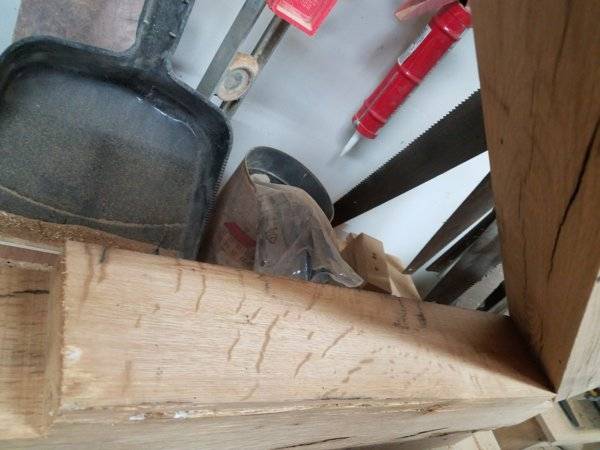

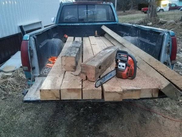

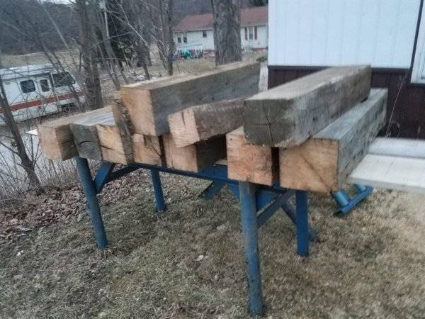

I tore down an old barn to make room for my new garage, after looking into selling the Chestnut and getting low balled I decided it would be a cool project to use it. Here's a few pictures of what I started with, the truck load is new white oak for the top.

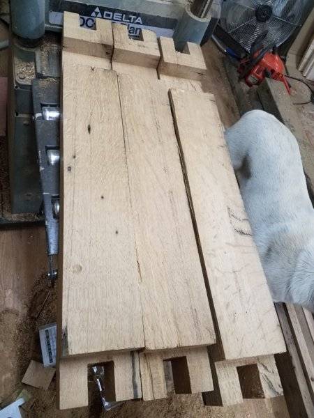

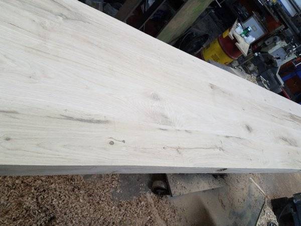

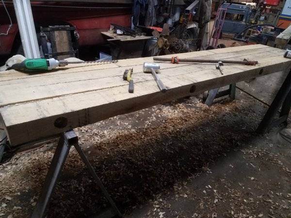

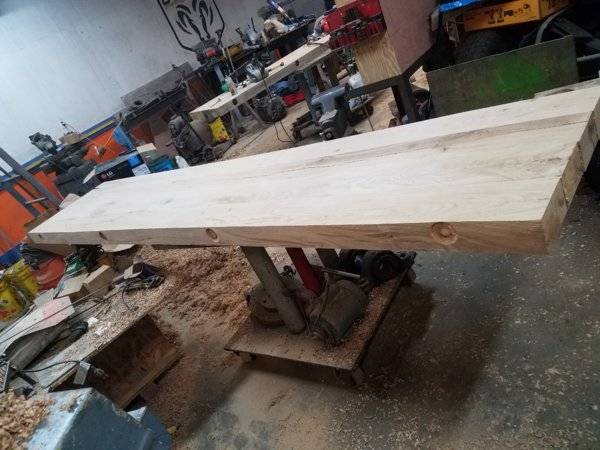

Here's the tops nearly complete. 4 pieces of 3"X6"X10' White Oak glued with 1/2" all thread bolting them together with the nuts well resessed. We recently got a 24" planer but my word were they a handful to work!!:eek: Thank goodness for dad's adjustable height workstations on casters cause I wasn't carying these things at likely 200+lbs each.

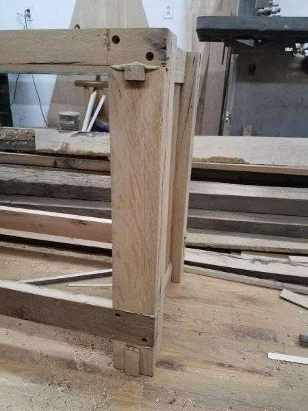

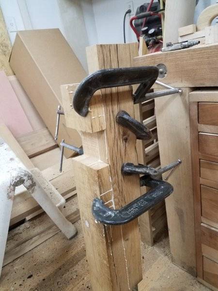

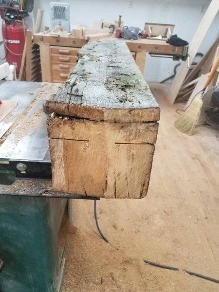

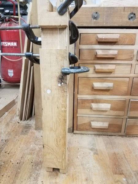

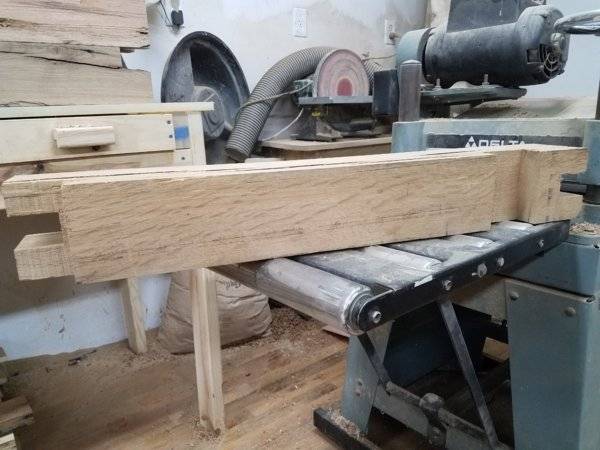

Here's where this project has proven to be fun lol. In my first post you can see an 8x8 where I'm sawing the nail filled face off, then planing the rot off... patching rot that didn't clean up:screwy:. All I can say is I'm glad we keep our dull blades cause the nails are eating them up! Last 2 pictures are a couple legs that were to pretty to toss so they got patched up.
Loving this grain!

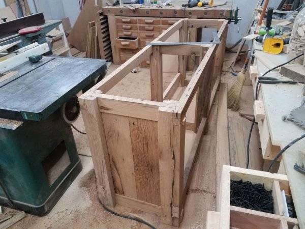

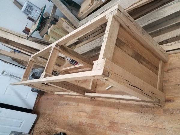

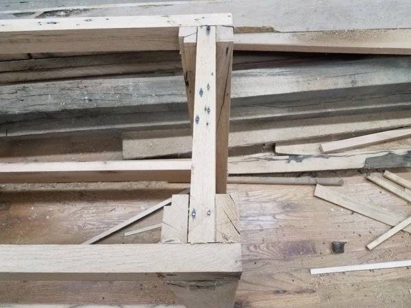

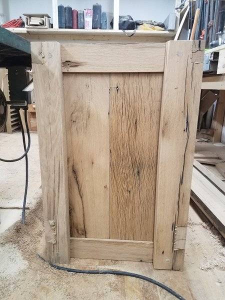

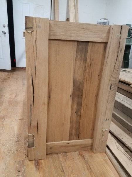

This is where I'm at now, rough frame pretty much done. The leg frames are all mortise and tendons with 5/8" oak pins drove threw then the rest is just set in a dado cut then glued and screwed... might chisel the screw plug holes square for an antique look? Only 2 leg frames got boards since they're the only ones exposed, the rest got 1/2" deep dado's in the inside so I can add plywood walls making drawer slides easier to install and to keep the cabinets separated. Also all of the plywood adds tremendous strength.
Oh yeah, I allowed for a toe kick.
Looks like you’re using polyurethane glue.
I used tight bond wood glue on most but did use some poly on the boards that tie it together. Main reason was all of the splits in the wood, I felt it would do a better job where the runny glue would seep away into the cracks? We'll see but I've found it to be extremely strong just a real mess to wash off. The other thing I was thinking about was all the hammering this thing will see, poly has give where other wood glues either hold or break?? Experimenting I guess.
Are you going to stain it or just clear it?
Definitely getting stained, I'll play around on some scrap but thinking maybe English Chestnut or Brown Mahogany? The base will likely get lacqer and the top will just get saturated with Linseed oil.
