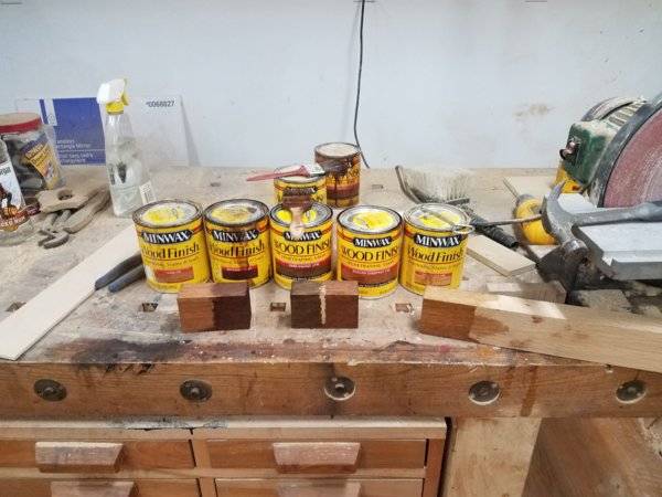

Thanks. My dad built that one, the top is Elm and I think the drawers are Maple.Very sweet work 747. You have a lot of skills. It looks like your tool bench behind your work area is also made of wood. Looks,like a nice tool cabinet.

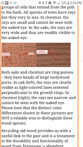

So you think this is white oak? I admit it has the same quarter sawn grain but I was certain it was Chestnut after some research? From what I've looked up it seams the end grain is the biggest indicator which this lumber matches plus it's not anything like white oak to work with but than again this came off of a 100+ year old barn too. If you've got some input please share so I'm not misrepresenting it since the thread title says Chestnut.Nice looking arts and craft frame there. Quarter sawn whits oak always looks good plus that is what I work in.
The bench top I made is white oak and they don't look alike other than grain, this wood is a very even in color all the way threw to the core and more of a light brown. Here's what I was looking for. Also it smells nothing like oak but again it's old so who knows what 100 year old oak smells like.Looks like 1/4 sawn oak. However so does Chestnut. I'll wet a piece of mine and take a picture.
It does look like white oak but you have your hands on it I don't. I was only commenting on the stained frame and mistook it for white oak. That looks like a wood I should check out some time. Ether way that is a beautiful arts and craft frame. What wood did you use for your square pegs?
