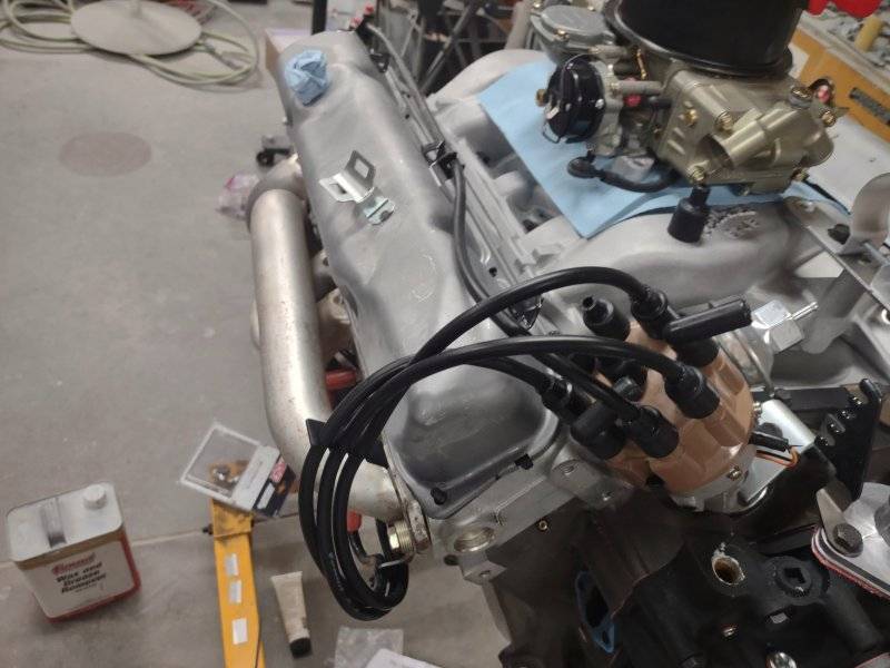

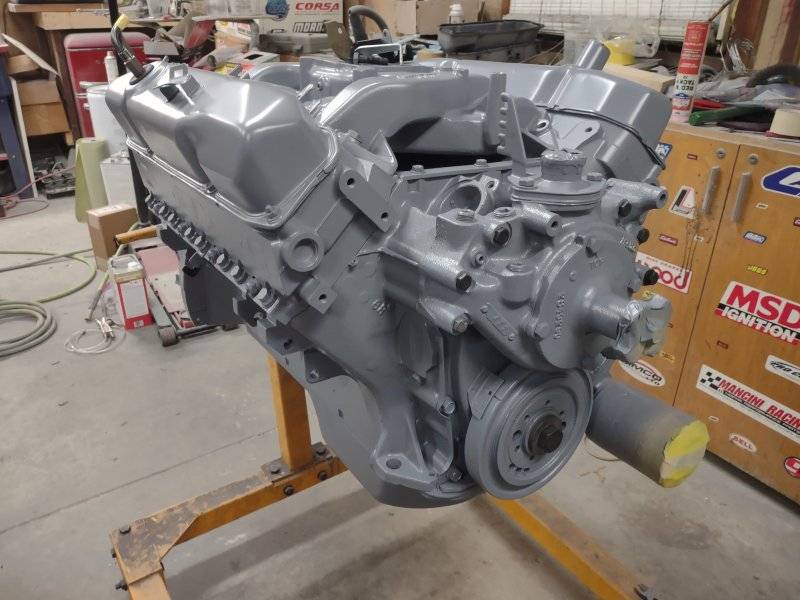

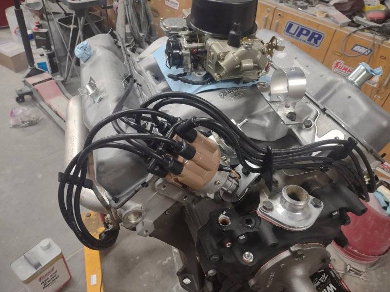

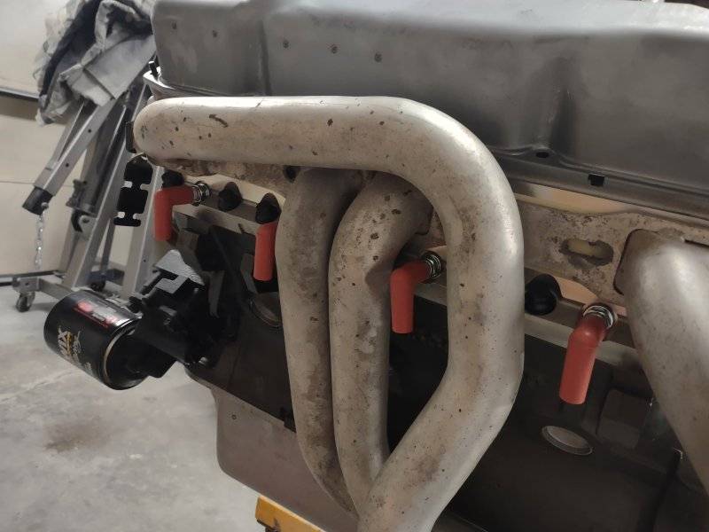

I got all of the body panels in epoxy primer and in the basement. Ended up picking up the engine from the builders. It was all broke in on the dyno and made right around 525hp/530tq. I had to do some mock up before putting the engine in primer. Since I'm running headers I couldn't just use factory plug wires but I wanted somewhat of the stock looking wires, so I decided to make my own. I bought all of the boots and a spool of wire and went to work. I bought the factory brackets to route them as correctly as possible.

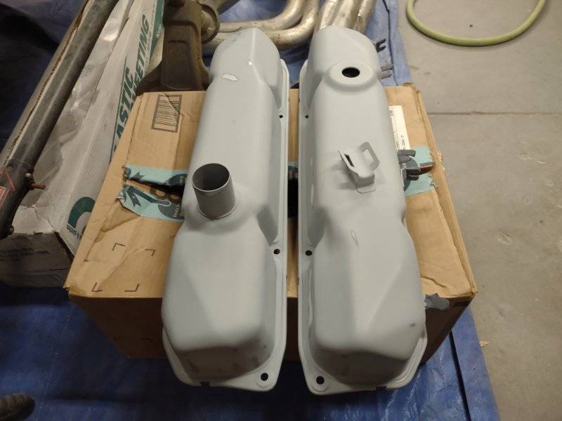

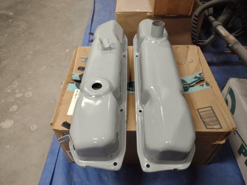

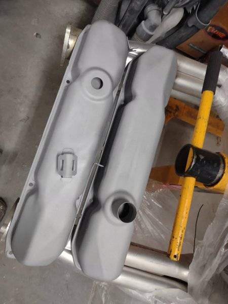

One issue that I had was with the valve covers. I had bought a set of AMD covers that leaked pretty badly while on the dyno. Rather than mess with them, I found a nice original set from Tony's Parts. I blasted them, bought new wire tabs and welded them on, redipped the tabs and spark plug wire holders in rubber, touched up a couple areas with filler, primed them and sanded them with 320. I installed them onto the motor so they would get primed with the engine.

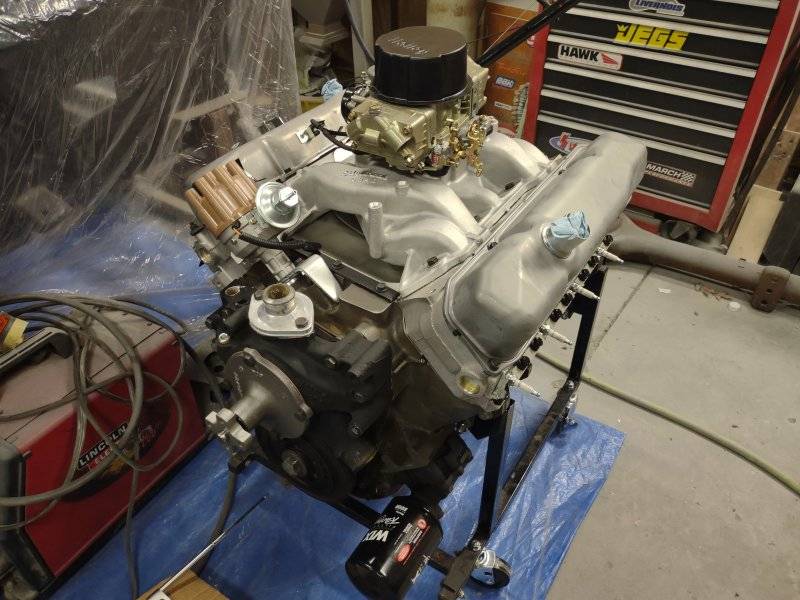

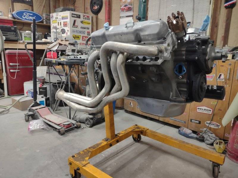

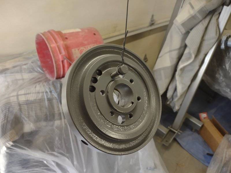

With the valve covers done, I wire wheeled and scuff padded the motor and washed it down with wax and grease remover twice then wiped it with wax and grease remover a couple of times. I then sprayed 2 coats of PPG epoxy on it and the components.
I put the engine back on the dolly and put an engine bag over it and tucked it away under the bench. Once the body is done I'll bring the engine back out, scuff it and shoot it with color.

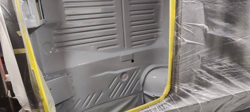

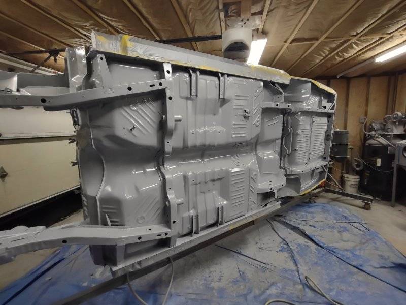

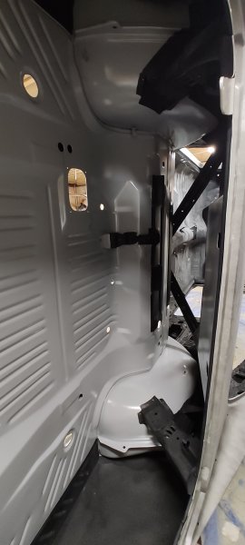

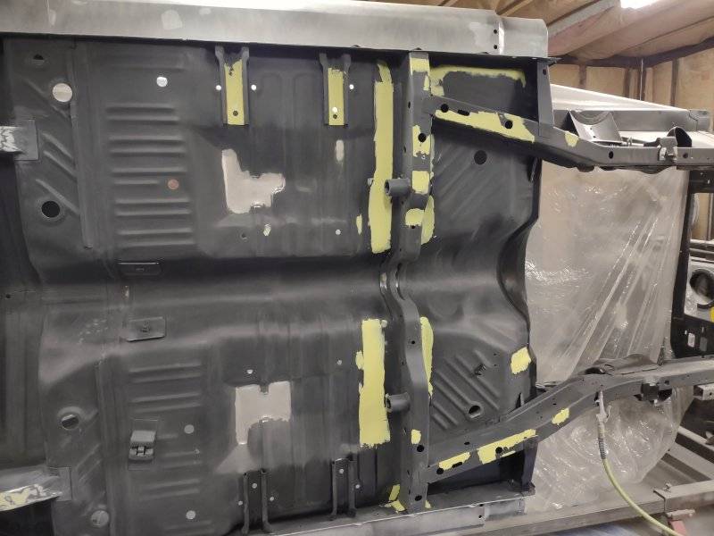

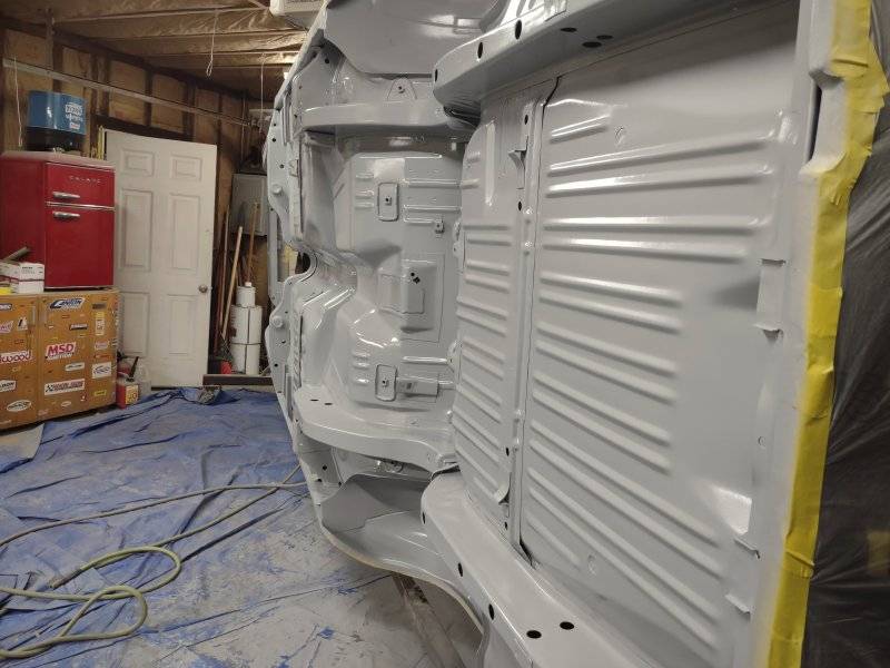

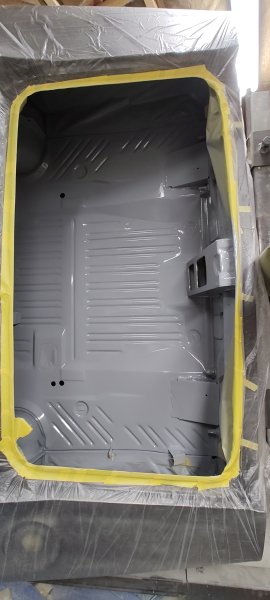

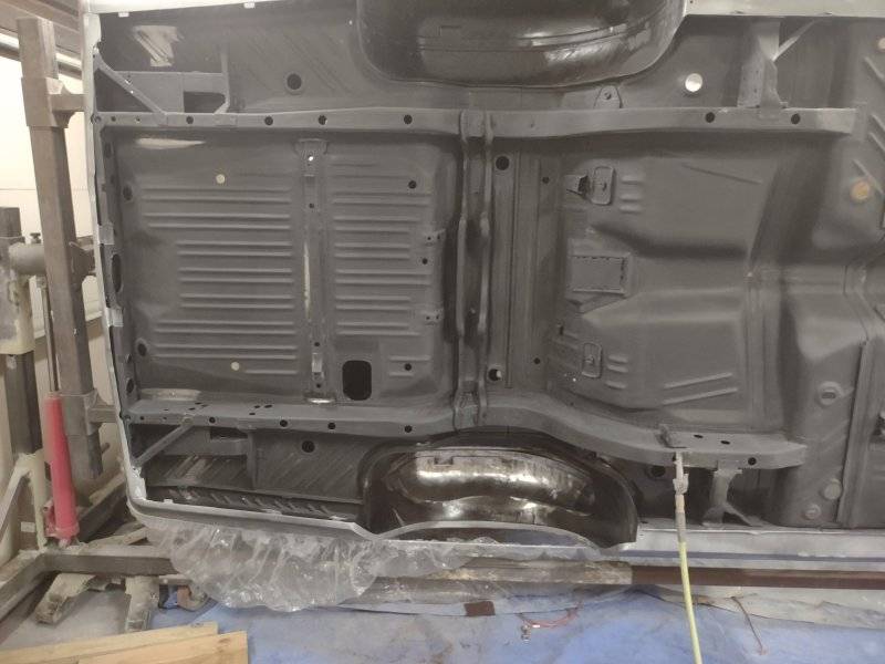

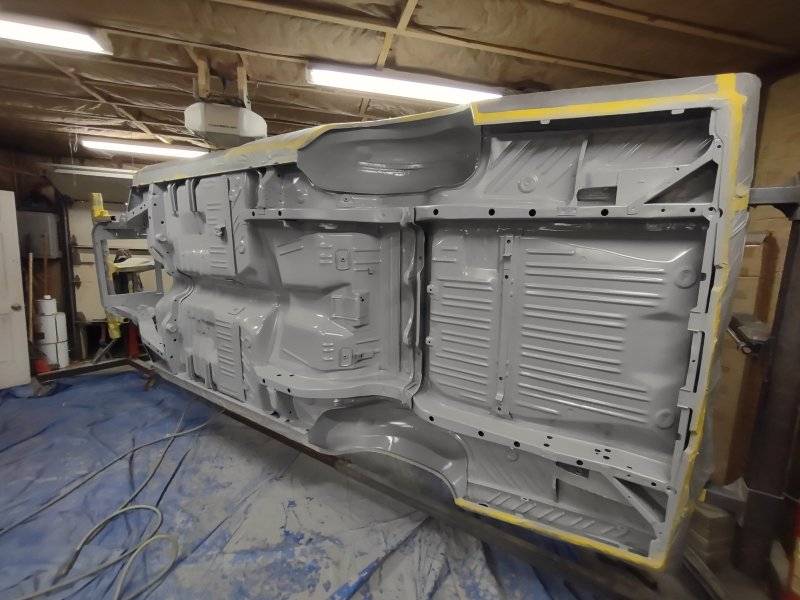

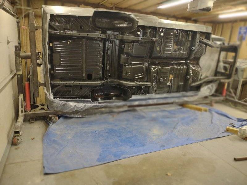

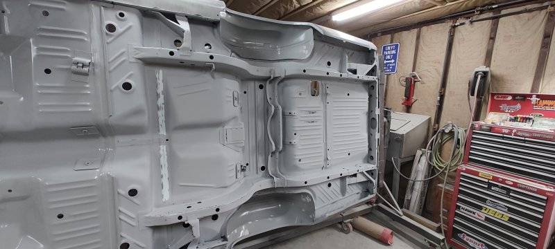

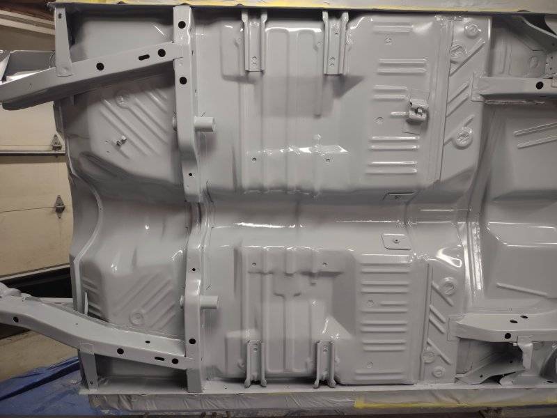

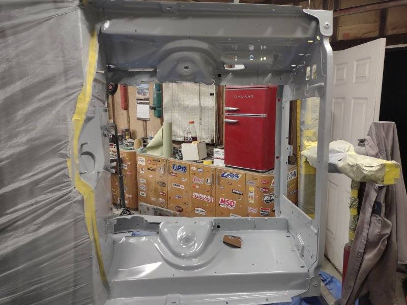

More updates. With the engine primed and tucked away, I continued on the body. I scuffed the e coat on the underside of the car, the engine bay and inside the trunk. I did any body work on those areas that needed it and then I sprayed everything with primer.

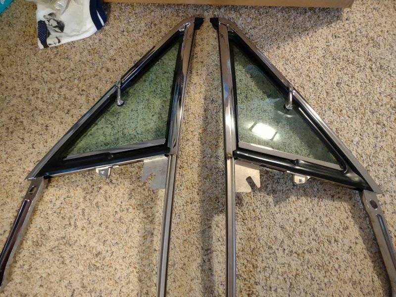

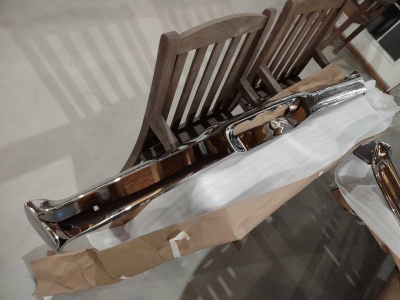

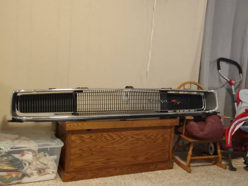

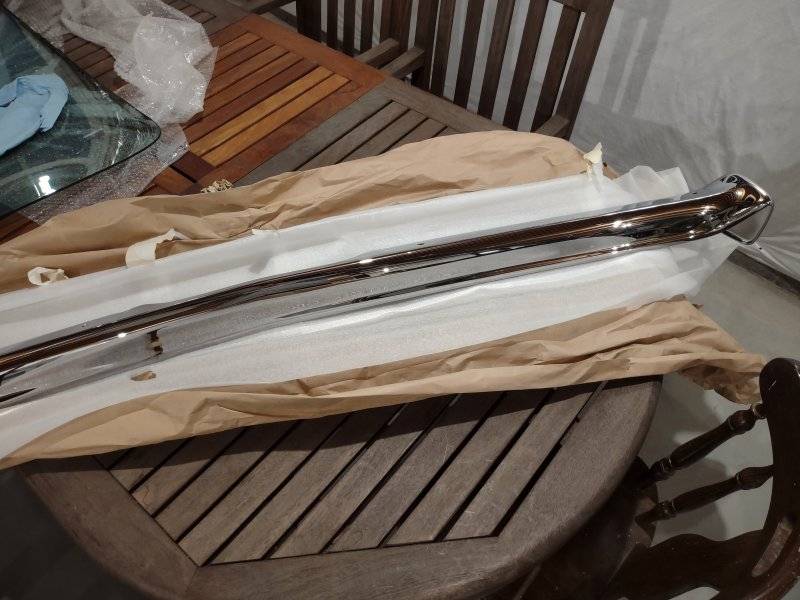

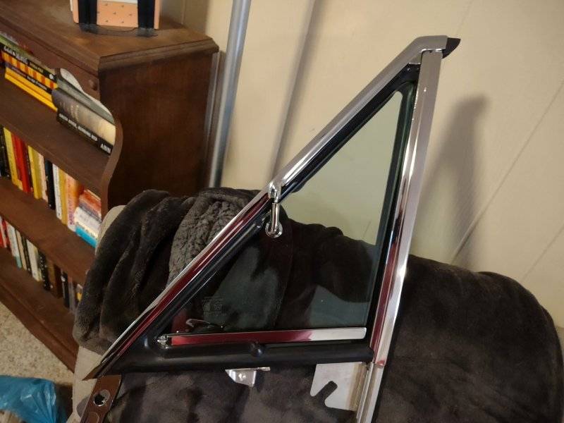

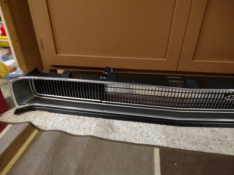

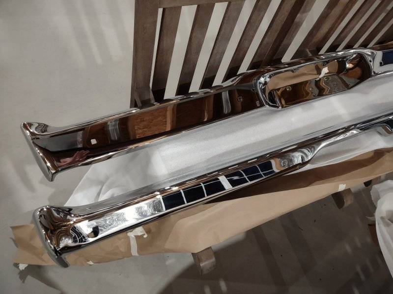

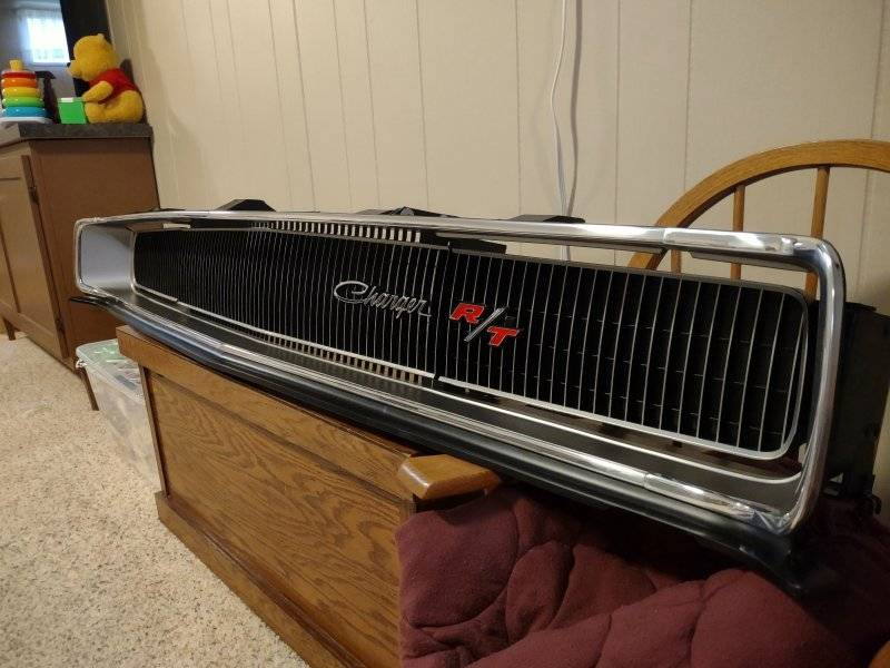

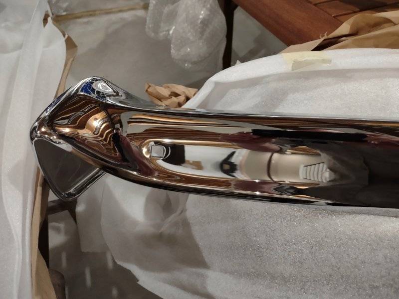

As I was sanding the body, I was also picking away at some other parts as well. We had Paul's Chrome rechrome everything as well as polish all of the trim. We got that stuff back so I was able to finish the grill and assemble the vent windows. All glass is new date coded pieces from ECS.
Looking good. Make sure you check the fitment of that rear AMD glass with the opening and your trim. There has been a lot of problems with it because the curve in it is not correct. Most guys were sending them back and finding a good original. This was up to at least a couple years ago. Maybe they got the problem corrected by now, idk.
Paul's did a great job on the chrome, the original bumpers look great.

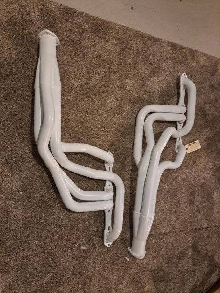

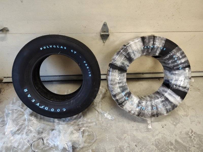

The car is going to have a slight Day Two look to it. We are going to be running redlines and magnums most of the time but will switch out the wheels with a set of Cragars and F-60 and L-60 Polyglas Goodyear's. The tires came in after over a year of waiting. We also had the TTI headers ceramic coated in white to give it that old school look. The coating is a traditional silver ceramic that they do and then the white goes over top. This helps to protect the white from yellowing
And currently I'm at the tedious task of sanding the underside, engine bay and inside of the trunk with 320 grit. After that I'll wet sand the outside of the body and then paint.
Will do, thank you
Pauls chrome is the best! Looks awesome. Congrats on the progress.
Pat
Thanks Pat, it's a shame that they went out of business a few months ago...
Nice, neither Vintage Tire or Coker could be bothered to tell me that the Polyglass are back in stock !
I just so happened to see a post on Facebook where someone posted a picture of them sitting at their door step. I called Kelsey Tire that day and they were shipped that evening.
