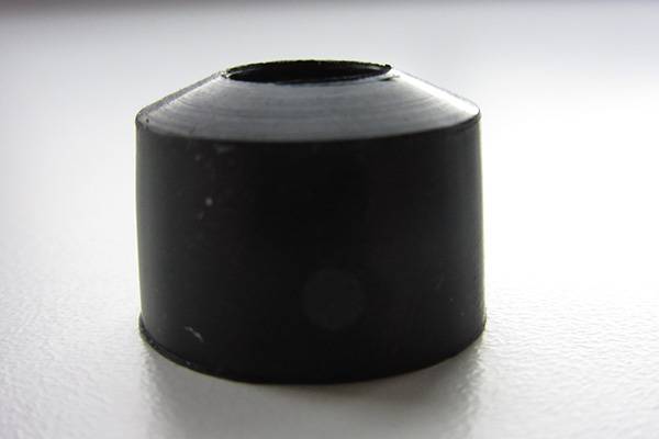

Holy Crap! That might be your problem. On a stock-type motor, you should have one of these on every valve stem (inside the valve spring). Some people call them "umbrella seals"
You should have one of these "inside" each valve spring.

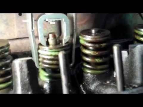

You get them out with a special adapter & compressed air running into the spark plug holes (with the piston up on that cylinder) using one of these tools
You have to look "inside" the valve springs to see them. They cost about $25-$35/set for the whole engine. They keep oil from going down into the cylinders, causing the engine to smoke out the tail pipes. They do get old & cracked (or forgotten!). IF you're missing these, that might be your only problem. Any cylinder that was missing at least one (they're on intake & exhaust valve) would have oily looking spark plugs & you'd be blowing black smoke out the back from the oil you'd be burning.
They are normally replaced during a valve job. You can do this easily with the heads off the engine, but with the heads ON the engine, you need the spark-plug-hole compressor trick..... but MUCH easier than taking of the heads. Maybe a shop can do it for you?

Question these valve stem seals do they fit snug to the bottom or do they go up and down with the valve stem?
There ar different types of seals. Umbrella, which is used in earlier engines on both valves, but on later (mid 70s-up) engines have umbrella on the exhaust and what is shown on the intake. Then there are positive type seals which are required for dual valve springs, and require the guides to be machined down. Those can be gold, or white, or blue depending on the manufacturer and seal material. Regardless of design, the engine MUST have valve seals and leaking or missing ones will smoke like mad at startup and high vacuum throttle positions.
