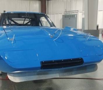

Chrysler Engineering Charger Daytona #88 restoration at Big Iron Garage
Details… Lanyards. Splitter also can be seen in nose.
Frame actually mounted upside down. Lined right up with the holes and vintage pics proved it.

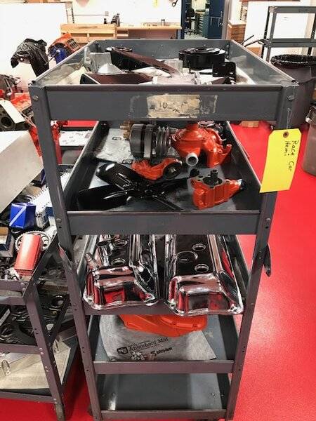

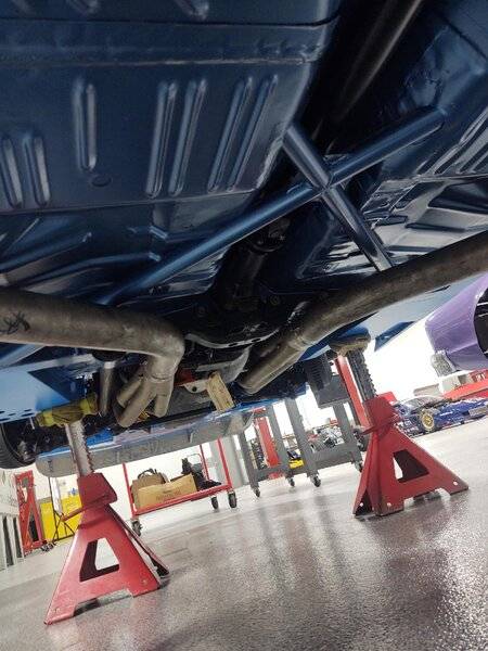

Lining up the original stainless steel headers and NOS dumps.

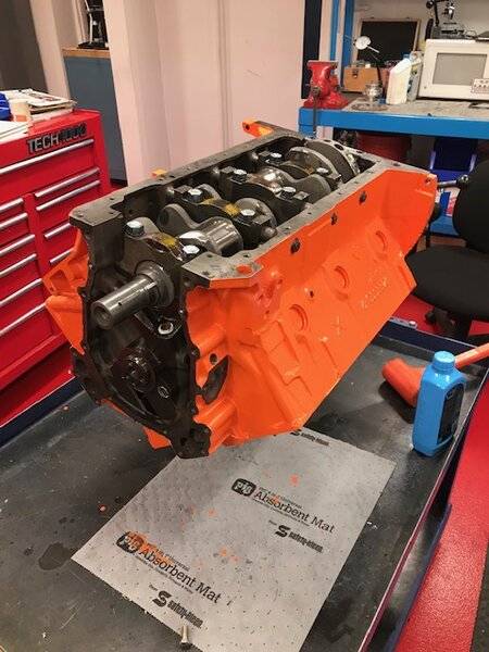

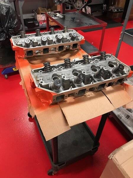

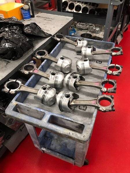

Chrysler Engineering serial number EX-144. Was in the car in Feb. 1969 when it was a Charger 500.
I thought the engine was already in? Is this a different engine or older photos?

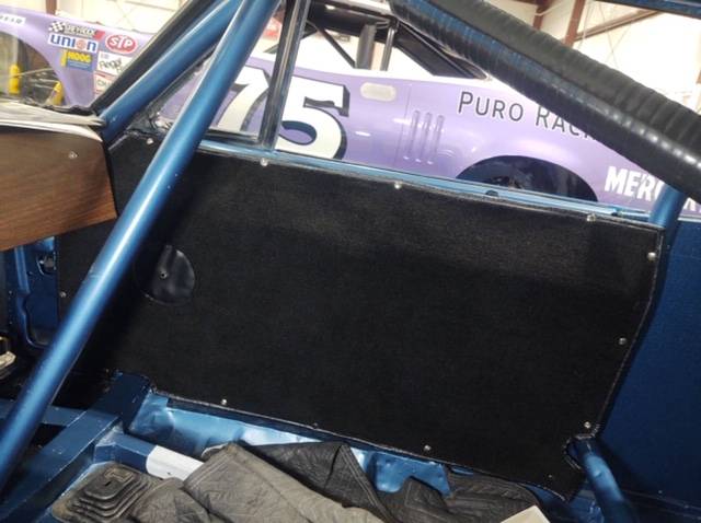

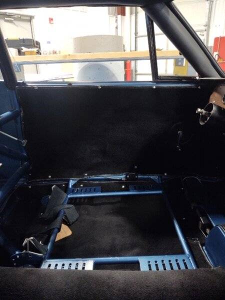

The high end Nichels Engineering stock cars had some carpeting in them.
The door carpeting was easy to redo. The original snap holes were there in the side bars of the cage.

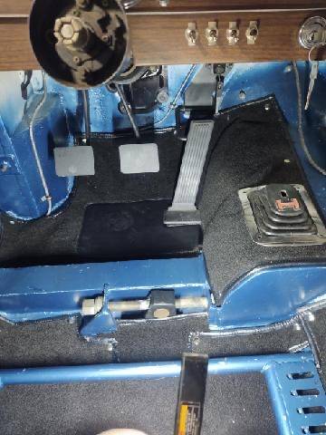

Floor carpeting was done using vintage pics. Don had modified the pans and then Iowa rain did its thing from 1976 until 1998.

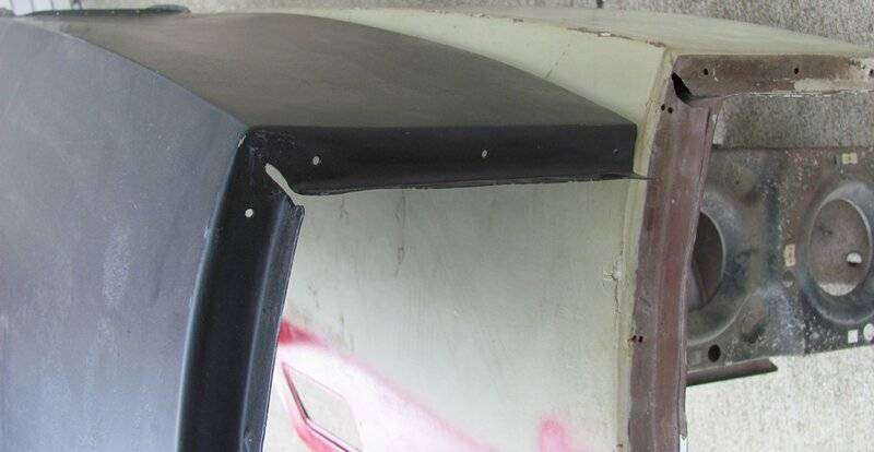

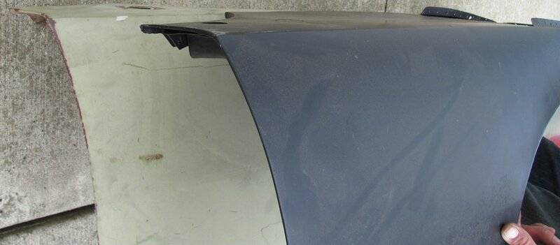

Here's what's meant by fender "droop".
Fender drops above the wheel, going forward.
Here's the original right #88 fender versus a production fender. I lined them up at the rear, as you can see.
Oddly enough, there are no cut and weld marks on the drooped part.
Maybe something that Nichels Engineering tweaked from a skin?
Are the fenders curved more than stock or is the rear edges of the fenders tweaked to make them angle downwards more?
The fender drops around the scoop area.
Scoop to rear, all stock. Back edge facing door, all stock.
