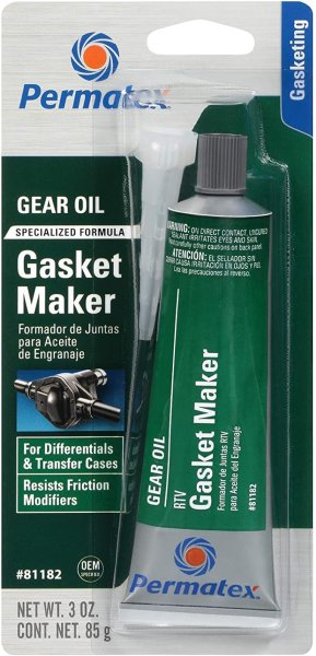

Is it leaking from the actual seal or between the yoke and pinion shaft?
I have seen this. Fluid crawls up the splines and exits behind the nut and washer or nut threads.
Little silicone on splines and threads will stop this.
I prefer a leather seal over the rubber ones. These are just thoughts.
Permatex makes a RTV sealer for gear oil. I always smear some of that on the splines before slipping on the yoke.
