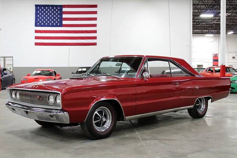

67 Coronet R/T Stainless wheel lip moulding and stainless rocker moulding. If that's what yours looks like it's stainless.
