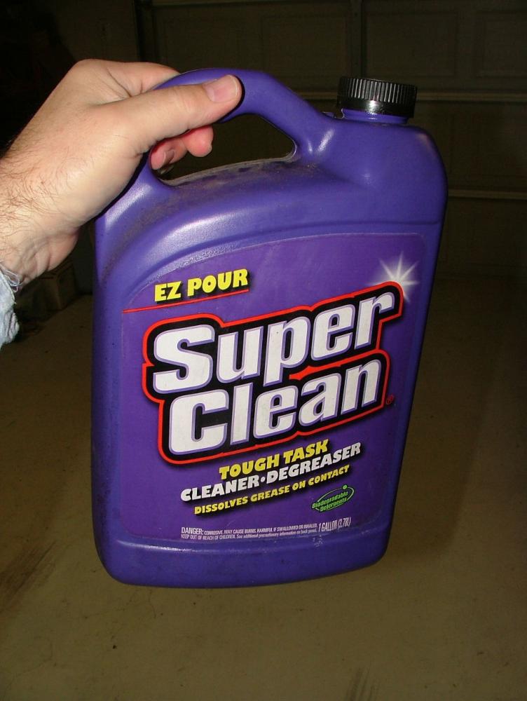

I've had good luck with Super Clean, available at Walmart and elsewhere. Buy a big plastic drop cloth, duct tape it to the garage floor, and position the engine compartment over it. Put a bunch of old towels around the edges to catch runoff. Scrape off any heavy buildup then spray Super clean on full strength. let it sit, and rinse it off with water from a spray bottle or a hose. Wear gloves and eye protection. It may need multiple applications but it does a great job without any fumes or toxic waste. Be sure to totally rinse it off with water as it can attack aluminum. It may strip some paint but in my experience this is rare. I've used this on a number of cars for underhood detailing with good results.
