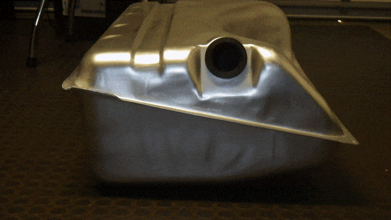

Here's the thing, I just went through this and decided to just replace it. I didn't trust trying to do it myself and paying someone to do it wasn't an option considering you can buy a new spectra tank for under $200

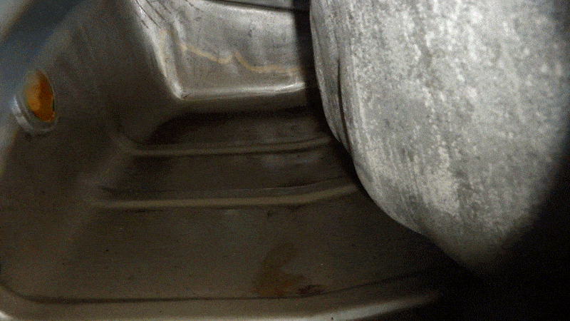

Just noticed that it's only 8 years old. I would just take a flashlight and look inside, if you don't see sediment on the bottom, then I wouldn't worry about it. Shouldn't be anything and fuel filter couldn't take care of. My tank was 49 years old

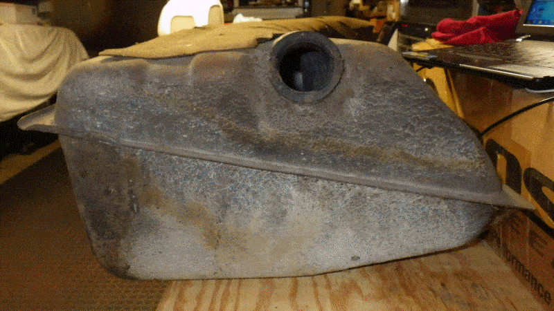

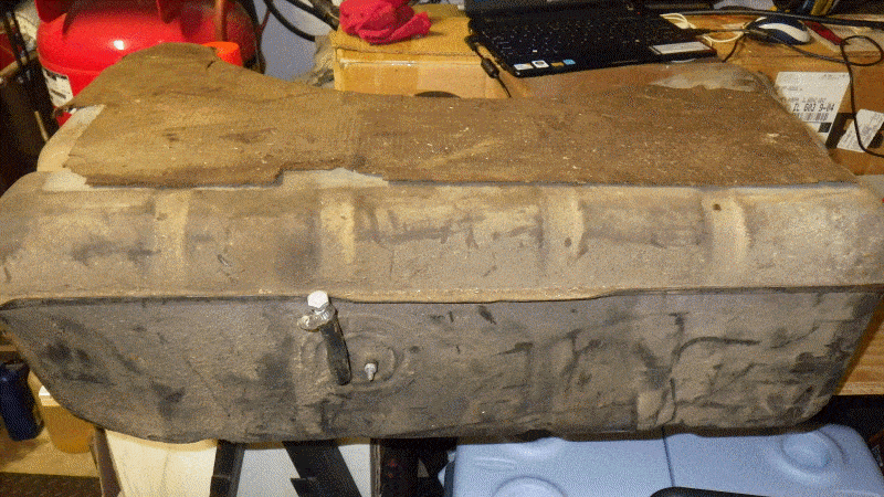

Pull it down and take a look inside! This one's a lot older.........
How did you do that?.....

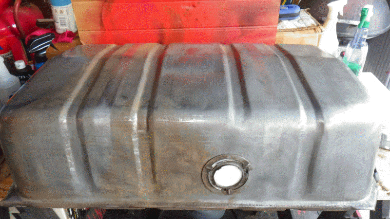

Lol, A lot of undercoating/sound deadener. Small thick hardened patches came off with just a thin blade paint scraper. But the stuff that was thinner caused me to consume a six pack. I also used bug and tar remover, wheel magic, and acetone. Soft wire brush the rusty areas. Rinse, wash, repeat.
No blasting was done on it.
