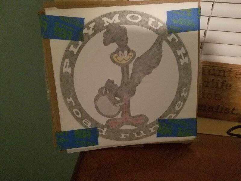

I am going to be putting stickers on my RR and was wondering if it was a good idea or bad idea to put on car before clear coating? Could it cause some kind of chemical reaction make a mess?

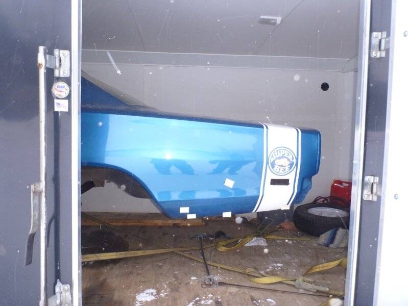

In 1988 we painted my stripe on the car and the Bee and letter decals where cleared over. Here it is still looking fine on it's way to body and paint in 2016 some 28 years later. Was PPG products of the day.... probably not recommended with todays formulations..
