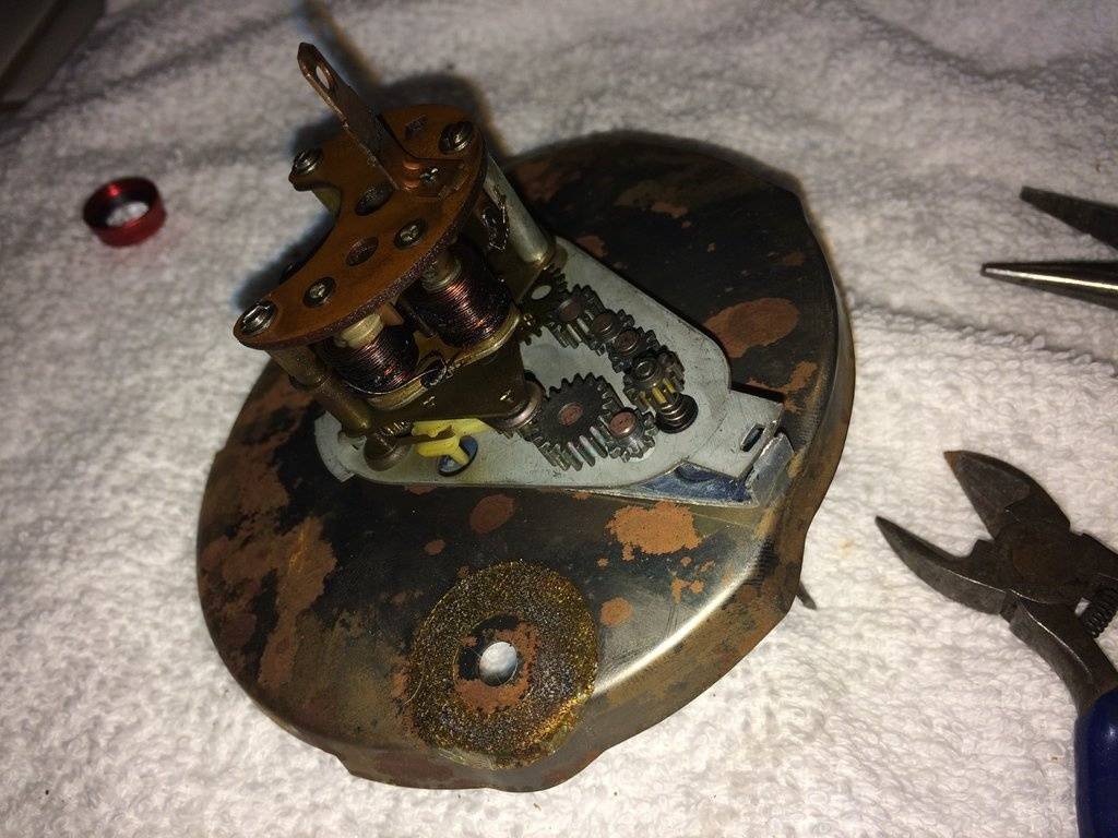

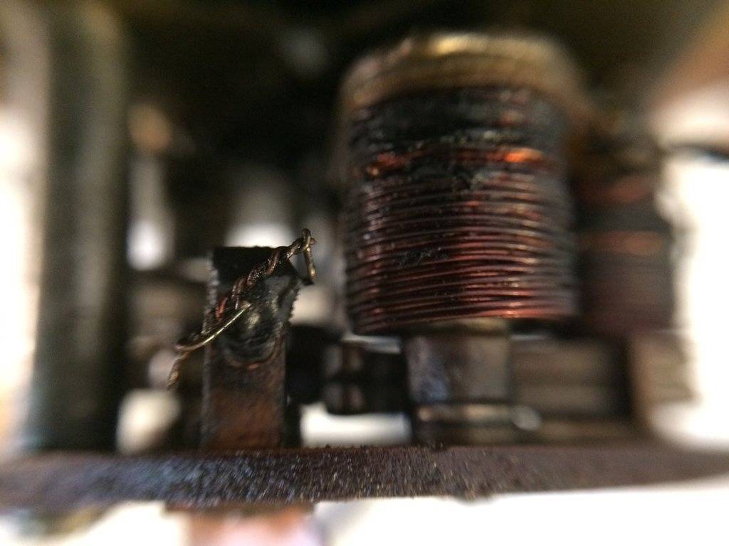

Clock is apart- coil is cooked.
For anyone else coming to do this job, here's what you'll see once the back over is removed. To get the cover off, there is one tab to bend, then look for for a couple other places on the back cover that are crimped over - this will need prying outward, then the cover will slide right off.

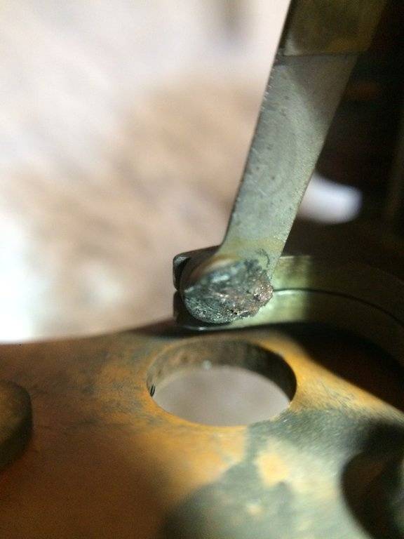

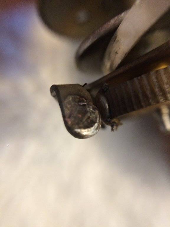

Feeling like i couldn't break it more than it already is, I decided to investigate the clock workings further and learn a little bit. I discovered that I could drive the points away from each other with a small screwdriver and that wouldn't affect wind the mechanism and then I could watch the workings of the clock operate for about 10 to 12 seconds until they came back in contact with each other and then it would stop. At that point I twisted the broken wires of the coil back together put 12 V to it to see if it would work. I had to drive the points apart to get it started and then as soon as they took it down and came in contact with each other there were some tiny sparks as it tried to re-energize itself, then it blew the three amp circuit breaker on my 12 V power supply. As you can see, the points are totally cooked. Way beyond filing. There is hardly anything left of them.
Yep, that's cooked. :(

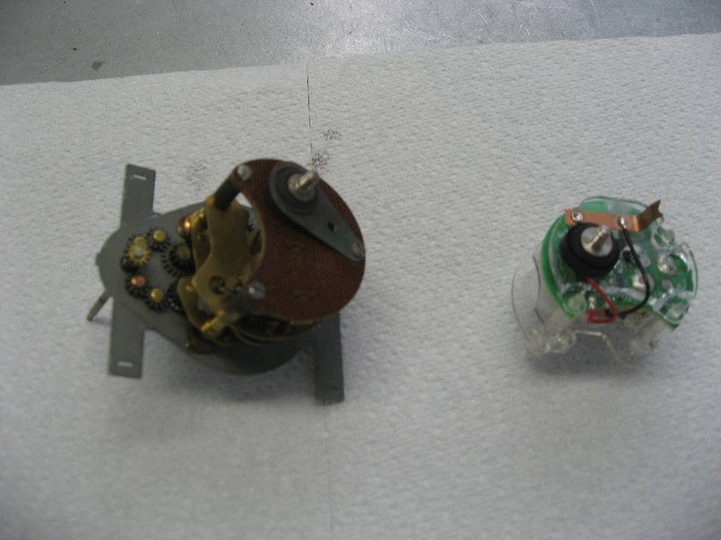

Had the same problem with my '66 'Net. Watchmaker got the original running but it gained 20 min./day before quitting again. Found this quartz replacement kit on line. Comes with a DVD & takes about an hour to do - once the clock is on the bench. Uses stock case, face & needles & hasn't skipped a beat in almost 3 years.
