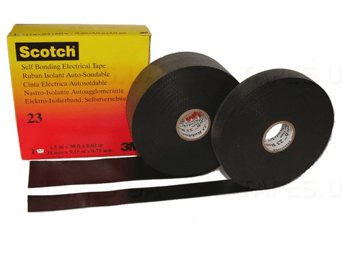

Even I bought the non sticky original tape, didn't buy enough on my Carlisle visit back in 2008 for the full car so I ended using 3M scotch selfbonding tape I found locally on mostly parts of my harnesses and still have storaged the non sticky tape around... I didn't take care of a FULL correctness, but just close enough. It resist heat and solvents and is hard to beat
