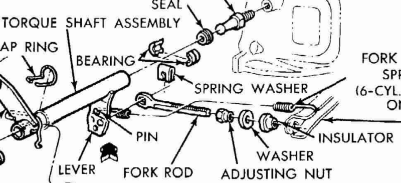

I didn't like what I saw with the linkage to clutch adjustment rod assembly - there
were a couple small parts missing (the snap clip and plastic washer, for example) and the rubber isolator (which was new when given to the guy) was chewed pretty badly also...
and I didn't like the angle the clutch adjusting rod was hitting the linkage from the pedal.
Seemed like to me those two should be pretty much dead parallel with one another, right?
Well, since the previous owner did the cobbled up job of converting the car to a 4 speed,
I figured the linkage wasn't exactly right down there (the z-bar doesn't come across from the frame ball pivot to the pivot on the bellhousing exactly square, for example) and was
probably throwing the geometry of things off a bit anyways...
BUT to those of you who have factory 4 speeds, are your clutch adjustment rods bent at what looks like a pretty good angle like the one in the Brewer's pic above?
Fortunately, I had a spare snap clip and plastic washer, but they weren't going on with the
mismatched angles of the adjustment rod and the z-bar lever - so I did the kind of thing
I usually do, namely took the adjustment rod out and over to the bench vise, where I beat hell out of it until that angle at the open end was gone.
(Took some doing - that rascal is TOUGH!)

Yes... that rod has a slight bend in it. Check the ball stud in the belhousing and your z bar. There are two different lengths.If you have the wrong length ball stud it will throw everything off including your adjustment on pedal. It will also be difficult adjusting for free play in pedal.

Reminds me, though - out of curiosity, is the correctly installed "bent" adjusting rod
facing with the "convex" side mated to the z-bar arm - or facing AWAY from it?

FSM shows it facing away from the torque shaft pin.
Thanks. That is the orientation that made the most sense to me as well, even after I beat the thing dang near straight.
