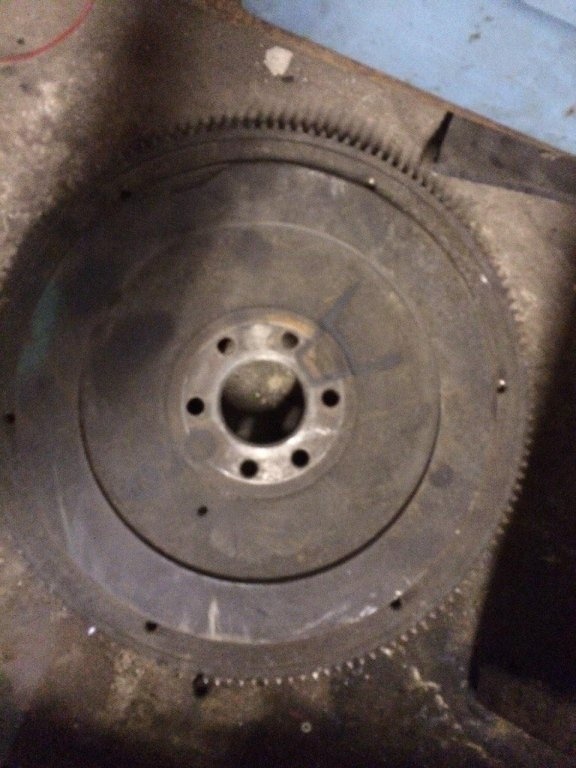

Im interested to buy a new clutch kit form my 68 Charger 383. So I disassembled old one and observed that old clutch is 280mm( ~11inch).
Could you please advise reasonable clutch kit 400-450hp, 23-spline.

flywheel's D= 352mm ( ~ 13.8583 inches).
Which clutch (10,5 or 11) size should I pick ?
You need to measure the surface of where the clutch disc rides. Also count the teeth, 130 tooth or 143 tooth.
So you have a 143 tooth, 23 spline clutch. That's what you need to look for from the companies that I listed.
I have no problem about that, my question is which clutch (10,5 or 11) size should I pick ?
Sounds like you have an 11 inch clutch, so I would get that.
