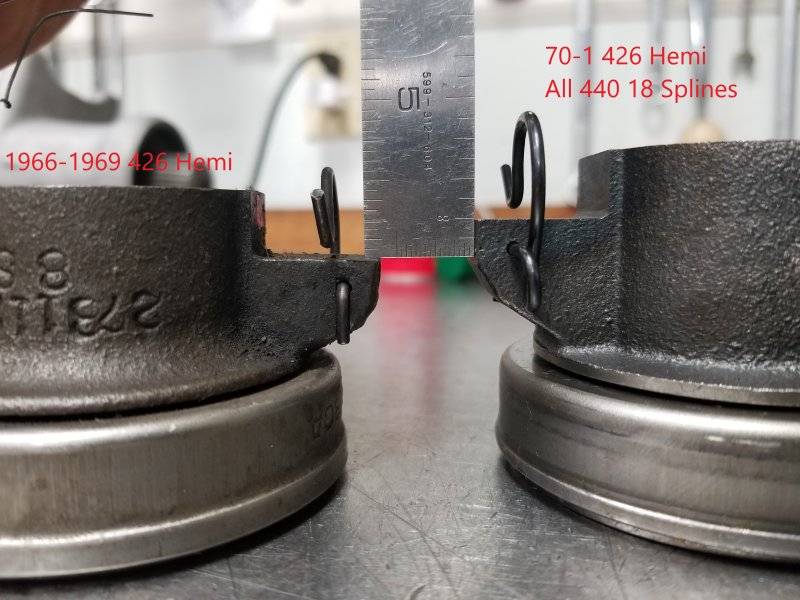

Make sure if you replace the clutch bearing, you use your collar. The 66-9 Hemi collar is shorter than the 440 or 70 & newer Hemi.

Thanks Dan,
I was aware of that. I had to machine one years ago to fit. My car is a bit of a challenge as it has one of those early nodular iron or cast steel scattershields. I just checked my log book and this Hays unit has 15000 miles on it until it got contaminated.

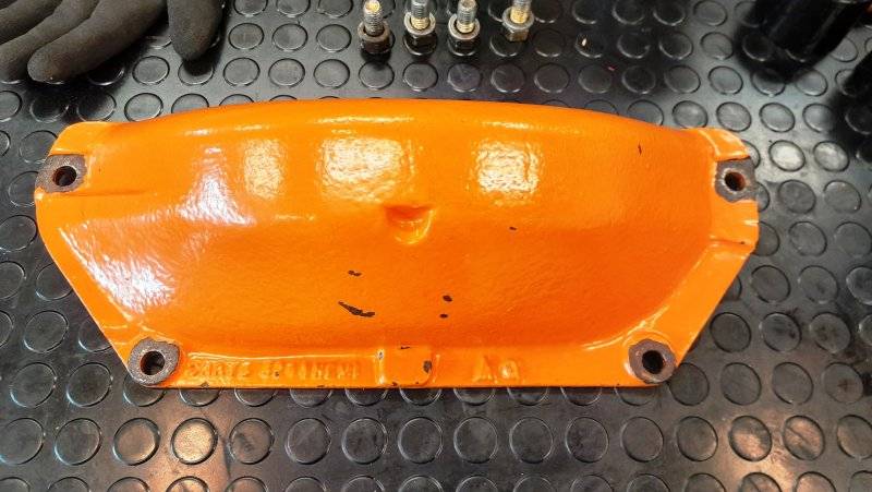

Is your bellhousing an old Ansen bellhousing style scatter shield? That is what I have in my 66 currently.
Matt
Matt

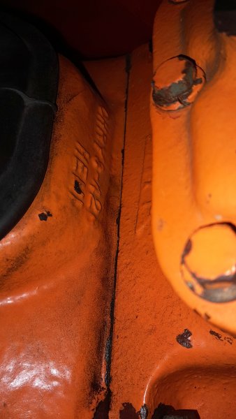

Not sure of the manufacturer. The only markings visible are:
CHRYS-426
HEMI
I believe there may be a 1964 date cast in it that I cannot see when it is in the car. I did have to machine the input bearing opening larger to fit the '69 bearing retainer. That material is hard! Sparks flying from the carbide cutter on the Bridgeport when it was being machined.
CHRYS-426
HEMI
