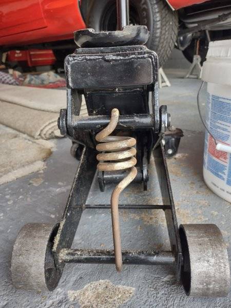

That's a great idea. Thanks for sharing.Hook it on the nose of a trolley jack between the front wheel shaft and the lift pad. Pump it up and put springs between the coils. Install spring and push pedal down and the washers fall out.
