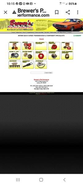

Brewers likes McLeod. Good enough for me.
Call Dan at Brewers, he will answer any questions you may have. A good Mopar guy.
(937)-947-4416.
