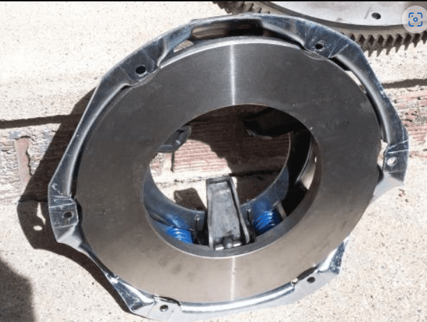

What the 11" scalloped PP (10.95") looked like.....
Bolts up to the 130-tooth flywheel.

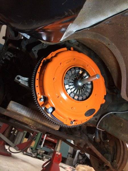

I went through the whole “10.950” clutch situation with Wayne Brewer. It is the standard clutch for my car, 1970 6bbl Plymouth with 130 flywheel and aluminum bellhousing. It required no alteration to any part, and is different that the 11” setup. I run a Centerforce pressure plate and clutch, that must be correct for the 10.950” setup, it has a lot of happy, abusive miles on it. I was just trying to make light of the fact that there is a 3rd size to look out for in the above posts, to try to help the OP.
I've used several of the 10.95's in the past. One thing though, keep an eye on the PP bolts/washers you use. Some combo's have too large of an od and can interfere with the disc.
