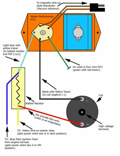

I know this could be a dumb question, but does it matter what side of the resistor the wire to the coil comes off of?
Yes it does. One side is full 12v (for starting), the other is I think about 9v (for running). Put the coil on the wrong side and you run full 12v all the time and probably reduce the coil life.
The reason I ask, the shop manual for my '67 appears to show it coming off the left side, while manual for my '64 shows the opposite.
Forget left or right side. Turn it upside down and the right side becomes the left side.
What I meant to ask here, does it matter if the plug-ins get switched side for side on the spades on the ballast resistor? I am thinking, no.
No, it wouldn’t matter. There’s no forward or backward on a resister.

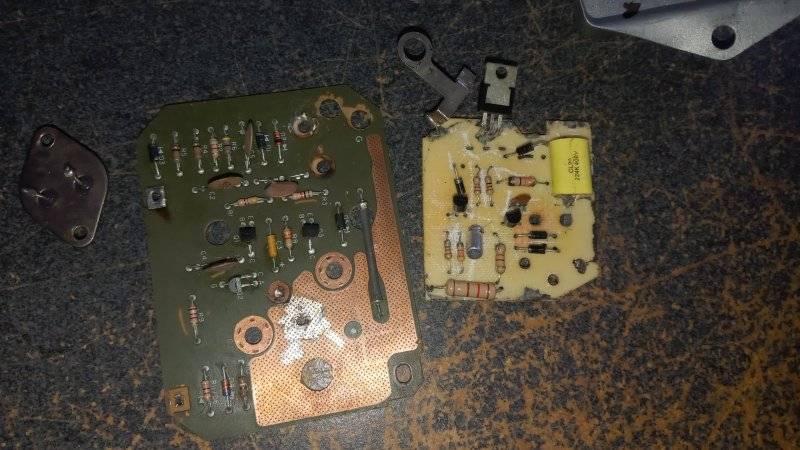

Having dissected a few orange box ECUs, the circuitry turns on the case mounted transistor, charging the coil's primary winding, thru the ballast resistor (which is bypassed during starting) to ground. The distributor's pick-up coil, in conjunction with the reluctor, generate the pulse, that triggers the internal dwell timing network, comprised of a programmable uni-junction transistor (UJT), which looks at the time interval between in coming trigger pulses (RPM increases) to allow sufficient charge time for the coil (rate of change of the primary current flow), which in turn, turns OFF the external case mounted transistor, causing the coil to produce the spark. The external case mounted transistor is a Power Darlington design, capable of withstanding the collapsing primary winding's induced voltage, yet allow for primary current flow. It usually fails because of a mis-matches coil and or incorrect ballast resistor, allowing excessive current flow and induced voltage conditions reflected back to the ECU. That's how the origional ECU worked.....the current Chinese stuff will likely have different components of possibly different designs....I've not had the opportunity to see. It is a basically coordinated components selection....change of one component will result in a failure......just my opinion of course,............

With the Mopar ECU the hardest (most heat) on the coil and ECU is having the ignition on, and the engine not running.
The ECU power transistor is "ON", and only turns "OFF" when it sees the signal from the magnetic pickup in the distributor.
With the engine not running, current through the Ballast/Coil/ECU transistor is basically only limited by the resistance of the coil windings and ballast resistor.
When the engine is running the coil has inductive reactance, a resistance that increases with frequency. This reduces the current through system as RPM increases.
For cranking, the ballast is by-passed just while cranking the engine.
What I'm saying is use the ACCessory key position for power when the engine is not running.
I have taken a lot of OEM and after market boxes apart. While chip tech has improved, quality still varies and construction of unit matters too. There is a reason automotive and mil spec cost more. On left OEM on right a cheapo box. Notice the board difference wrt heatsink and noise supression and quality of the mounting of the components. I have seen better circuit boards in toys than the cheapo ECU. The power transistor was only heat sunk by friction with the ground tab. Only one ground joint to the ECU body. Mopar OEM unit much higher quality.

- What exactly is wrong, or what is worse, about the mounting of the components on the aftermarket unit?
- you cannot gauge the 'quality' of components [ resistor, diode, capacitor etc ] by looking at them.
- the aftermarket unit uses a TO-220 or similar power transistor. These are smaller than the original big TO-3 design used by Chrysler & are used in modern day electronics. They require less heat sinking. A similar, or same, design is used in the GM HEI module, which switches more current than the Chr transistor & is no less reliable.
- the coils cannot 'overcurrent' because current is limited by the 0.5 ohm bal res.

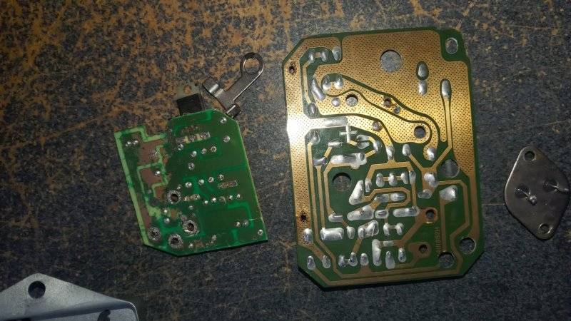

Ok, but you are wrong. Look at the quality of the PCB. It is built with EMI shielding embedded and thick trace. The ground is via 2 tabs. Look at the solder joints. The device leads are bent over to lock in place with a solid solder joint on the trace. This prevents vibration cracking. I know the TO-220 device is current packaging, but it should not have been floated for heat sink purposes. Exposes it to much higher temperature which is a leading killer of electronic parts besides voltage spikes. You can also visibly from the paint marks determine the tolerance of the resistor and also the quality and wattage rating. If you purchase electronic parts, and I do for a hobby business, there is a big price difference between common parts and milspec parts of the same type. That board probably has $1 worth of parts at the overseas manufacturer. And less in labor.
The circuit board in that aftermarket is a POS lowest cost assembly. It is obvious if you looked at it.

That is a really clean Mopar ECU board, how did you get all the potting material off it? Looks like the one from the old Orange MP box?
I think counterfeit parts and poor quality control is creating issues with replacement parts, not to mention they are trying to get the cost down to make the most profit.

Post #33. No, I am not wrong. I will deal with the BS:
- On the aftermarket cct bd, I can clearly see the gold tolerance band on some of the resistors. This is the 5% tolerance range for tighter resistance control; 10% is more common, & 5% cost more. Far from scrimp on quality, I see a 1watt res on the aftermarket unit & only 1/4 & 1/2 watt on the factory unit. The 4th resistor from the left at the top of the stock unit looks burned; one reason for that is underrated in wattage. Maybe that is upgraded in the new unit with a 1w resistor.
- The EMI shield. It has one, it is called the metal case. The most sensitive part of the cct to spurious emissions is the p/up leads, where a few induced millivolts can cause false triggering. I use Co-ax cable for the p/up leads on some installations. Chry chose not to use any form of shielding for the p/up leads. I see no problem with the cct board & is representative of types used today.
- the power trans could well be the SOT-93 package, rated at 15 amps. Some TO-218 types look very similar & are rated for 25 amp. Since the trans is only switching about 4 amps, it is well below it's rated capacity & doesn't need a heat sink. Look at the so-called heat sinking of a GM module on a Chev dist. Dist at rear of engine, copping all the engine heat from convection. Then, the dist is being heated by conduction being bolted to the engine. This hot surface is supposedly a heat sink for the power trans inside the module. The so-called heat sink in this instance may well be hotter than the device trying to shed heat...but it survives!
- overheat & overcurrent are NOT the same. I said overcurrent. Because of the design, it would be near impossible for 0.5 ohm the bal res, which is limiting the current, to reduce in value & cause an overcurrent condition. They mostly go open cct, cannot see how they would short cct. - the coil has copper windings; these increase in resistance [ less current ] as the coil heats up.
- if the coil overheats with the correct bal res, then the combination was badly designed. This is not the case with the Chry system; the engineers allowed for prolonged periods of idling/slow running.

What is the source of over heat? Current. I am sorry your wrong and inserting partial truths as red herrings. You seem to want to argue for argue sake. You can't see the quality of construction and soldering method?
You might want to do some reading on ignition systems and also electronics. Even on circuit board there needs to be emi protection. The metal case does not prevent interferrence on the circuit board itself. The signals on the board have to be conditioned and protected. Even trace routing especially on a multilayer board can effect how circuits accuracy and function. That cheapo one watt should be compared to the wire wound resistor on the OEM board. Also the circuits are different. A good ECU will do Voltage Regulation at input. Condition trigger signal, protect from stray signals and suppress voltage spikes to protect components, control dwell. The OEM has 4 transistors vice 3, more components for conditioning and protection.
It is hard for me to believe you think the cheapo board is a better board?
I used a heat gun and acetone to remove the potting. Which is another difference between the two units. Proper potting also has heat dissipation qualities. The OEM board was harder to clean because the potting surrounded the board. The cheapo was barely in contact and just a sealant.
I am not arguing that newer electronic can't work, I am saying some of these ECU made overseas (that have a reputation of failing) are not made well. Contruction and quality of components matter.
