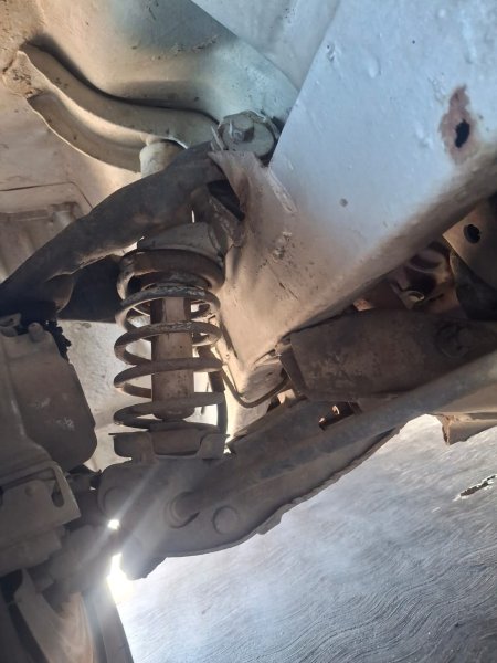

I was surprised today when a 1971 Dodge Dart with a K-member arrived and what I saw was a coil spring underneath. I was surprised. The owner of the vehicle told me that its ride is very smooth and the alignment is correct. He tells me that's all that was modified; it still has its original rubber bushings and the car can handle the weight. If this is possible, please let me know. I want to adapt it to a Dodge Coronet Station Wagon 1971 CustomBecause it reduces its weight distribution when gripping, it becomes negatively balanced, and the hubs are fine. But I want comfort and a smooth ride. It doesn't get stiffer, it gets softer; the spiral determines the position, and the torsion bar doesn't exert as much force. Obviously, the lower arm has to be reinforced. Here's a photo. Please tell me your opinion. I'm from Venezuela and I love the Mopar world, but the industry that designs bushings, replacement parts, etc., is awful. My lower bushings are imported Moogs.

The area where that coil spring is (in your picture) was not designed to take the additional load. The torsion bar cars were designed to transfer spring loads from the control arm to the torsion bar crossmember that runs across the car underneath the front seat. These cars were designed a certain way to be strong yet as light as they could be made to save weight and money. The frame rails where the shock absorbers are was designed to handle the stresses of dampening suspension movement but not to support the car.
You can reinforce the frame but a much better way to go if you want additional front stiffness is bigger torsion bars.
^^^^ This. Plus, you have added unsprung weight with the coil spring, which is never good for handling.

The vehicle in the photo has torsion bars, the lower arm is well reinforced and gives it an incredible, even height; the car has had this modification for years. And it's doing very well in its daily use because if the modification were bad it would always be parked due to problems with the front suspension, but it lives its day-to-day life.
It isn't the lower control arm that is the issue. The other end of the spring transmits force to an area that was not designed to carry the load.

Obviously, the area where the upper end of the spring is located is reinforced to withstand the spring's force; that's what I saw when I was underneath the car.

Here in the States, if someone rolled into a shop with a car that was modified like the one you posted, we'd think he was an idiot.
Don't repeat what that guy did.
To repeat, get bigger torsion bars and a good set of shocks. The stock equipment was okay when new but these cars do benefit from increases in spring rate to give a firmer ride and better handling.

QA1's coil spring k-member for Darts and B-bodies has a tower for the coil spring built into it. Well, at least it does in the pictures on their website - may not be actual product?
