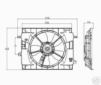

I also believe a Chevrolet HHR fan is a direct fit for our OEM radiator. This is the fan I was looking into years ago.
