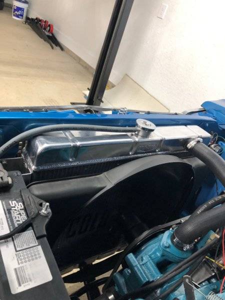

I just ordered my second cold case radiator today. This is a very nice product for those that are wondering. As members we get a nice discount .
I know how everyone loves it when a thread is resurrected...lol. Just wanted to put my $.02 in. A 2-3 years ago I had a 73 Vette I did an LS3 swap in-I used a ECP Radiator and never really got it to fit right, granted is was a swap scenario. Then last year I finished my 69 GTO and was thinking about ordering an ECP radiator but went to the Pontiac forums and did some reading. Griffin is the radiator of choice over there, they make a very nice radiator and truly set the standard but there is a price tag that comes with that a high price tag. After more reading I settled on the Cold Case and have never looked back-it fit like a glove and I have had zero cooling issues with a heavily modified 455. I had the luxury of having the ECP and the CC side by side and the quality of the CC is far above the ECP. I saw CC getting slammed because they are not USA manufactured but neither is ECP so not where that info came from. If I choose not to re-core and keep the stock radiator in the RR I will without hesitation buy a CC-even without a discount. Once again just my $.02 worth
