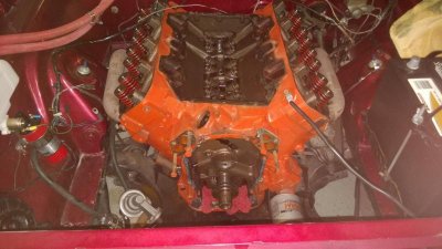

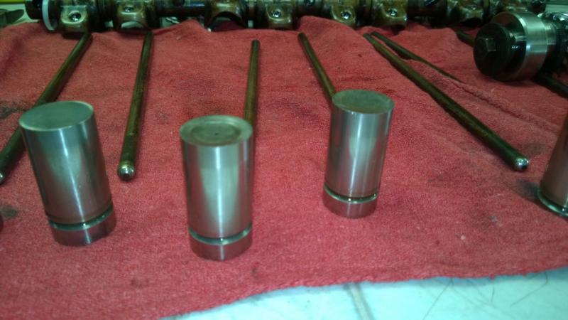

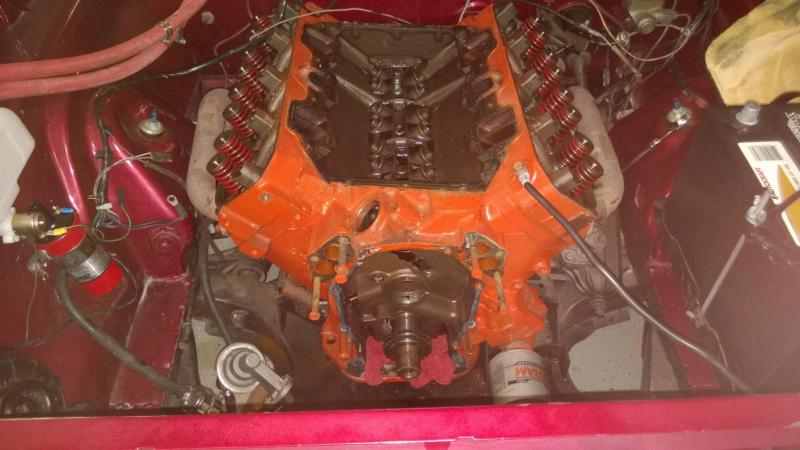

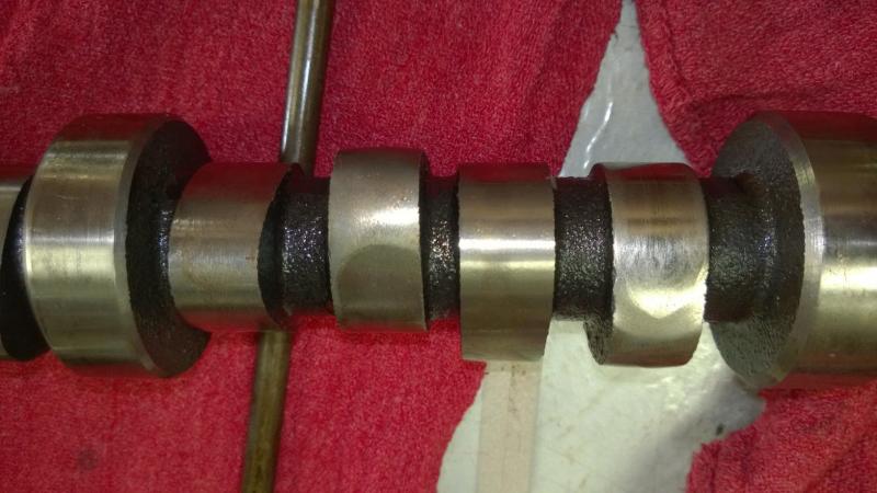

Well, I've pulled it apart. The news isn't good.
I have two severely scalloped lifters on #3, both intake and exhaust side by side.
The other 14 lifters look like new.
I started rotating the engine by the crank to have a look at the lobes on this 292 purpleshaft
and...you guessed it...the two lobes for #3 are visibly much lower in lift and the hardening/shine
has been worn off them.
Reckon that's what they mean by "the cam is wiped"?
Damn. Just damn.
To get this close, only to have this happen. Makes me wanna cry.

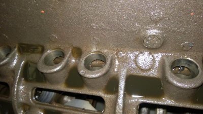

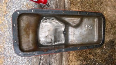

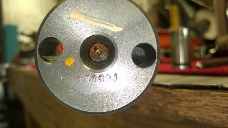

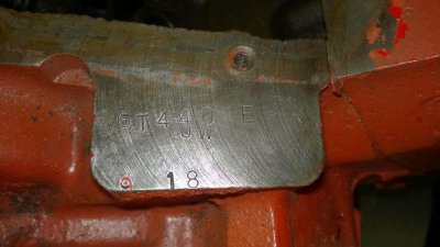

Everyone likes pics, right?
Well, here ya go. Scalloped lifters, wiped cam, etc.
I won't be getting another purpleshaft, that's for damn sure.
Suggestions?
are those the stock red magnum springs? if so it ain't the cams fault. check the valve seals to see if they're clobbered and roll the push rods across a flat surface to make sure they aren't bent.
