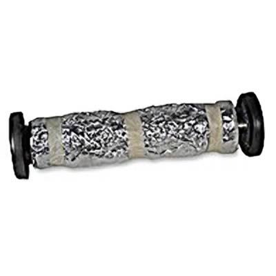

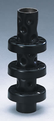

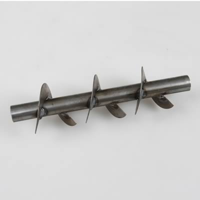

like these, from Summit racing... I've never tried them thou, but it may not be a bad idea if you live in a quite neighborhood & don't want to piss off the people that aren't car people... my neighbors don't mind as long as it's not early morning or late evening, my neighbor with 2 little children ,I will ask if the kids are napping before I start sometimes with open headers...

If you go to the Summit site and look up exhaust insert there are about 7 pages worth. I like the ones that Budnicks posted on the right. They make a two disc baffle that is meant for race cars, though I would never run with it.

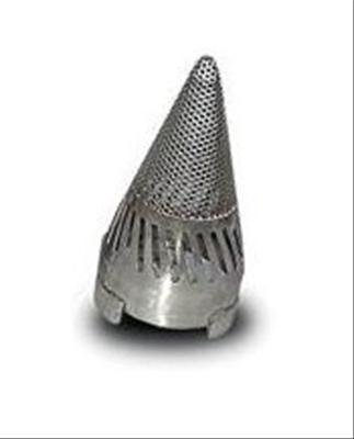

:iamwithstupid: I wonder if the reversion cone inserts or screens would tame the noise any ??, we used something very similar on outlaw spint cars many, many moons ago, I don't remember if the changed the volume much at all, but they supposedly helped with alcohol injected cars & cold air reversion in the headers/exhaust thou, before they made everyone go to mufflers, then we just used to old Coned style Super Traps with as many discs we could get on them....

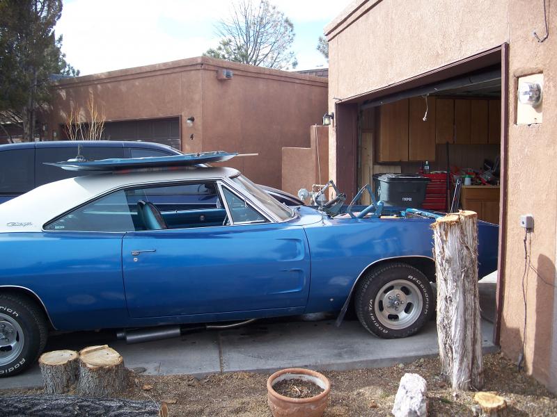

charger side ways.jpg heres what I did, I bought 12 ft of flexible exhaust tubing that slips over my reducer, cut it in half and stuck it inside my un mounted mufflers which I layed under the car looks funny but it works like a charm. the tubing cost me 14 bucks. you can see what it looks like in this pic
