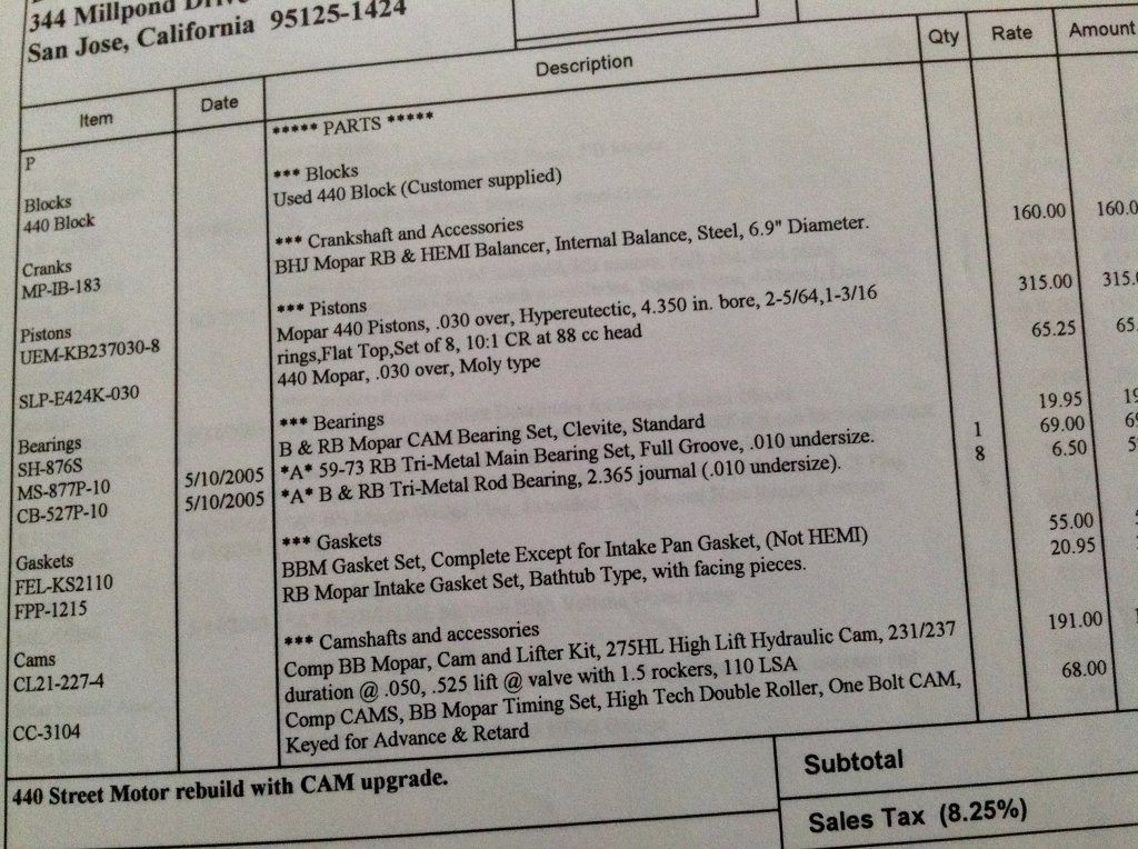

This 275HL Comp Cam was part of the build built back in 2005. Lots of hard miles. Has a killer lope and tons of low end power to 4850. No problems. After break-in, I have used Amsoil Synthetic Signature with high zinc 10-40 exclusively.
