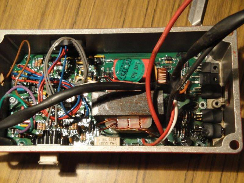

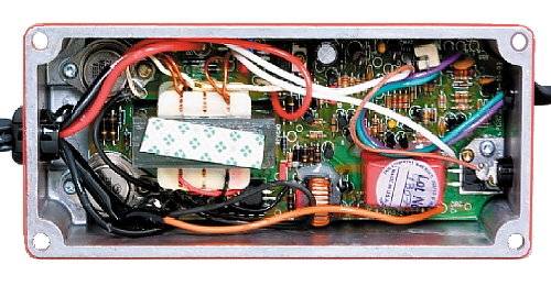

Most forums have an electronic ignition vs points argument regularly so this is probably starting another one. I have 4 old cars, 3 with dual points and an old Vette with reproduction Transistor Ignition in it. I’ve been towed home 4 times in my life in daily and vintage cars, 3 for electronic ignition failures and once for another issue. Never been stranded by points. I haven’t been on a track in 50 years so just a street cruiser and basically a points guy. I got the photos and idea from a member on Corvette Forums.
So you're out in the evening at your local cruise night and ready to pack it in and head home or you’re on your way home from a car show in a neighboring city. Which would you count on to get you home without issue?
This:
Or this:
The more I run these old cars with the newer chinese parts on them, the more I tend to agree with this. The key is finding good old NORS kits for points and stashing them. The newer ones aren't as good there either. I have been buying NOS and NORS electronic ignition boxes which seem to be way better than the newer junk as well.
This:
View attachment 1470077View attachment 1470078
Or this:
This:
Or this:
