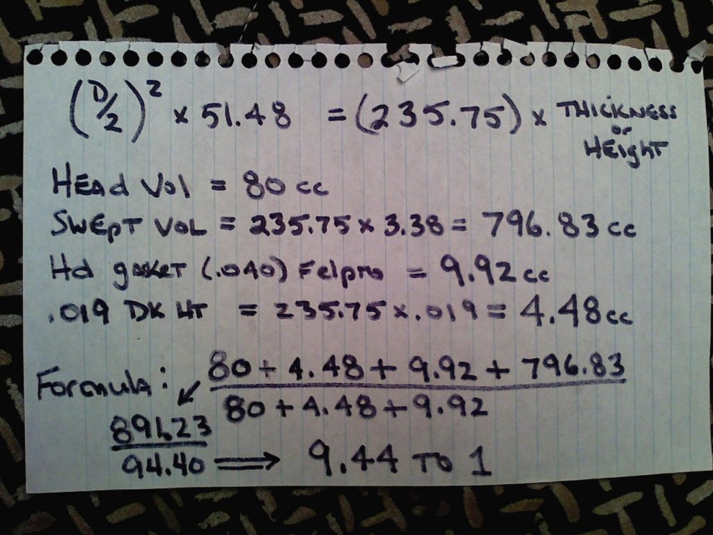

This is what I use ....
Yep, factory steel shim head gaskets were .020 ^^ like what dryheat posted above.Then put in the factory + or - of .5 and that gets you close to the 9.5 to 10.0 range.
383's are hard to get big compression out of with flat top pistons because of the short stroke. My 383 with -.005" deck flat top pistons and 915's with comp gaskets yielded 9.5:1. If this is a street car 9.5:1 is plenty.
You're math is right. The factory blocks are taller than blueprint too. So it is substantially lower than what the books said and without cutom pistons there's not much you can do about it aside from milling the heads to reduce the chambers when running aluminum heads. The E street heads come with a smaller chamber than the RPMs IIRC.
