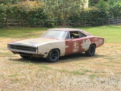

It was the 383 I rebuilt for this car:
I had first planned to hone the cylinders and rebuild the 383 with the stock pistons. They sat .076 in the hole though. THis put me about a point under the goal.
I ended up going .030 over and using Speed Pro pistons that sat .025 below deck, then decked the block to get them at .014. I was aiming to be in the 9.25 CR. The heads I have were milled before I got them and when I checked the volume, they came in at either 83 or 84 ccs. My final CR was something like 9.2 or close to that....right where I was hoping to be.
