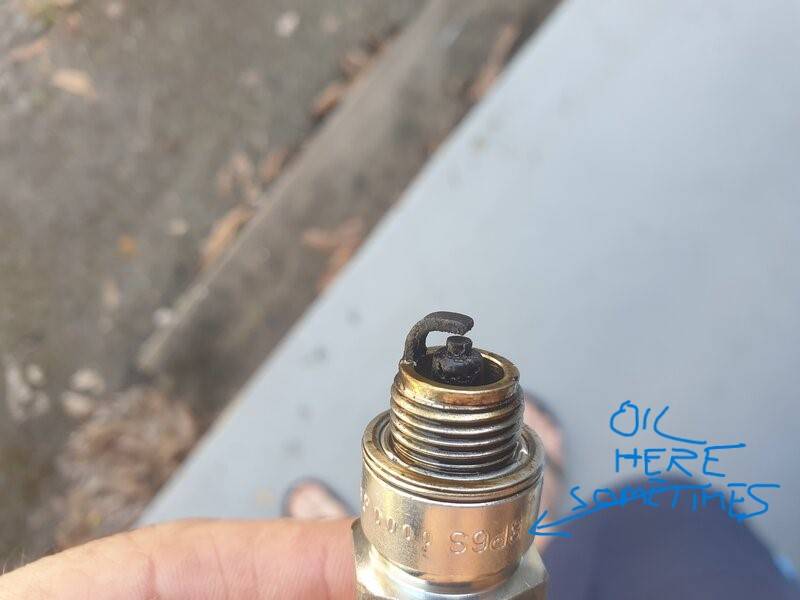

I did a compression test today on my poly. Nothing much wrong with the engine in terms of driving, runs fine, but one plug at the back of the engine always fouls up, crusty oil deposits (cylinder 7). It's done it for ages, I just take the plug out and clean it up periodically and put it back in. I've tried a colder plug (NGK 6 instead of 5), made no difference. Test was done with engine warm. It's 10.8:1 compression, forged pistons.

So everything looked good but the last cylinder I checked was the one I was concerned with. It had the highest reading which I'm thinking is due to oil leaking in there, but I'm unsure. Would this be a sign of an valve stem seal problem on this cylinder?
A couple of times when pulling this plug there has been oil on the shell of the plug - I thought it might have run down from the back of the valve cover but it seems dry there. Could it wick up the threads internally and pass the gasket, or maybe getted dragged onto there as I'm pulling the plug out?

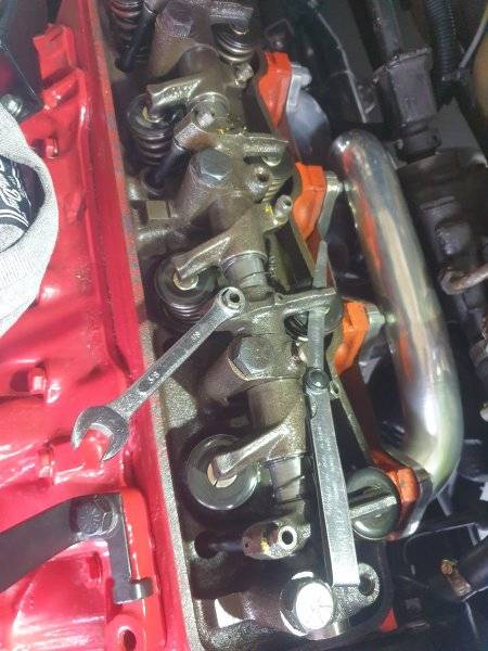

On some of the old polys you had to pull the rocker shaft out the end of the head I believe.. that true?
The seals are new as are the guides, valves, pistons, crank, rods etc (4 years old). I'm assuming a defective part.
Rockers slide to the side once the adjuster is backed off, the shaft is held in by the head bolts so that stays in place.
Looks like carbon to me, not oil ash. I’d check the cap and wire first before going too deep
You need a hotter plug, NGK 4 [ You cannot get a BP4S, only BP 4]. Colder plug will build up deposits quicker, will not burn off. I have been helping a mate with a 403 Olds, he got some last week. I use 4s in my engine & I also 4s in a drag race engine that I tune, it ran 119 mph.
It looks like the rocker shaft hold downs are cast into the heads , is that the case?
Another trick that does not require air to remove spring, use clothesline. Feed through the spark plug hole. Leave lead outside hole. Bring piston up. Will hold valves closed and allow you to change seal.
