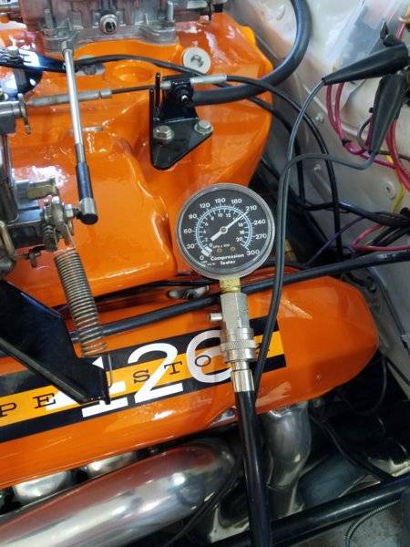

I did a compression test today, motor has about 140 passes since freshening up. Flat top pistons and indy little easy heads. 499ci. Any comments?
272/276 @.050 cam. Picture looked blurry, it was showing 215psi
Comment - It reads 210
If the other seven are 210 , I would say it probably runs pretty damn good and your happy
What cam ?
My little 383/432 is at 200 dead nuts on all eight this spring
And that was cold with the throttle plates closed , air cleaner off
Honestly I was a little surprised with those numbers recently after I rebuilt it a few years back
I would have thought 160/180 max
I just picked up another new gauge at Iola WI to confirm my confirmation that those numbers are confirmed
LOL
I was typing while you where reading my mind
All cylinders were above 200, runs 10teens with that crappie max wedge intake thru the mufflers
Sounds like LOTS of static compression ratio!
