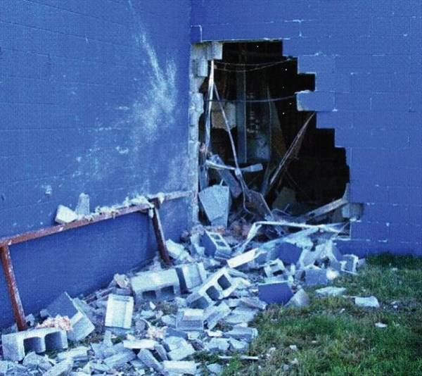

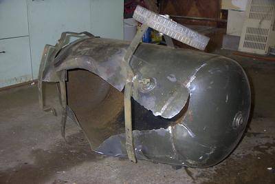

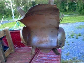

This one is very scary!a lot of black friday sales going on all over ,watch out for old compressor tanks they like to blow up ,you can scope them but I would replace I've seen one that has blown upView attachment 543254View attachment 543255View attachment 543257View attachment 543258View attachment 543259![]()
