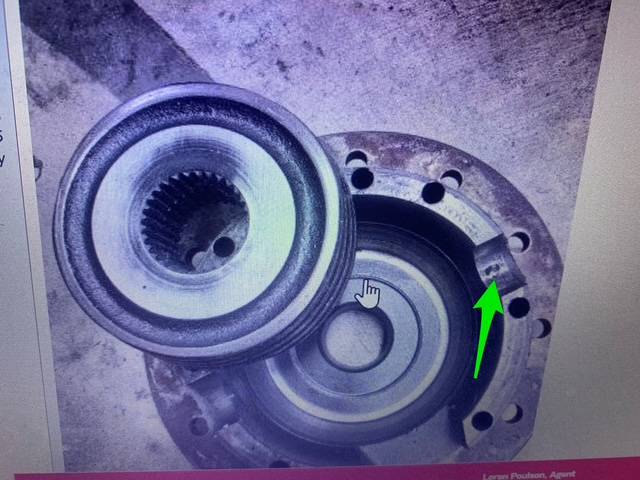

@Charlie Brown The small pin is the anti-rotation pin and keeps the cross shaft from rotating in the diff case. Wouldn't hurt to polish the areas a bit where the gears run on it and check the bores of the gears too to make sure they are nice and smooth. The only time those gears turn is when the car makes a turn. One more thing....if the LSD ever becomes a single wheel peel, don't try to make it lock by jumping on the gas thinking that will make it lock because it won't. What it will do is turn it into a piece of junk and pretty fast.
