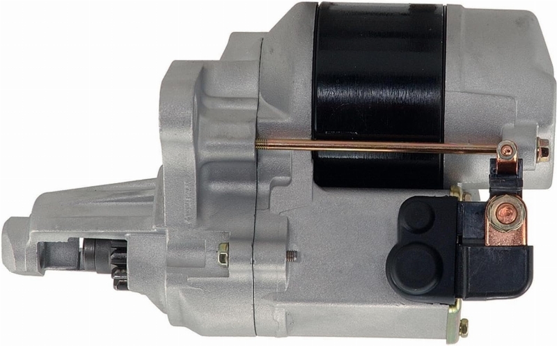

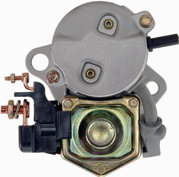

Looking at some pics, will this work? One of the reviews is from a guy with a '68 Charger 383 saying he has to "remove the extension so the battery cable would fit".
Name is on the box only, I’d buy one local that away if there are any issues your not paying frieght
You always have to remove the power wire extension. That's for a smallblock.

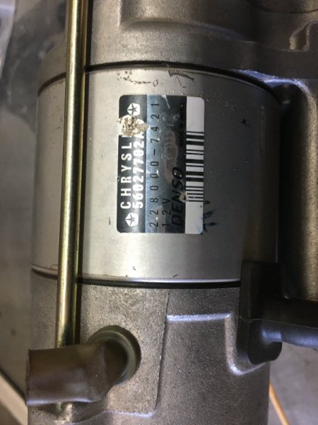

Try asking for a starter for a 67 new Yorker. It will likely be a mini, for the old starter price

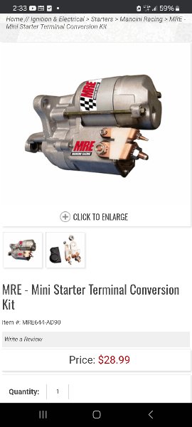

I used this one on my 71. No problems at all. get the cable relocation kit.
