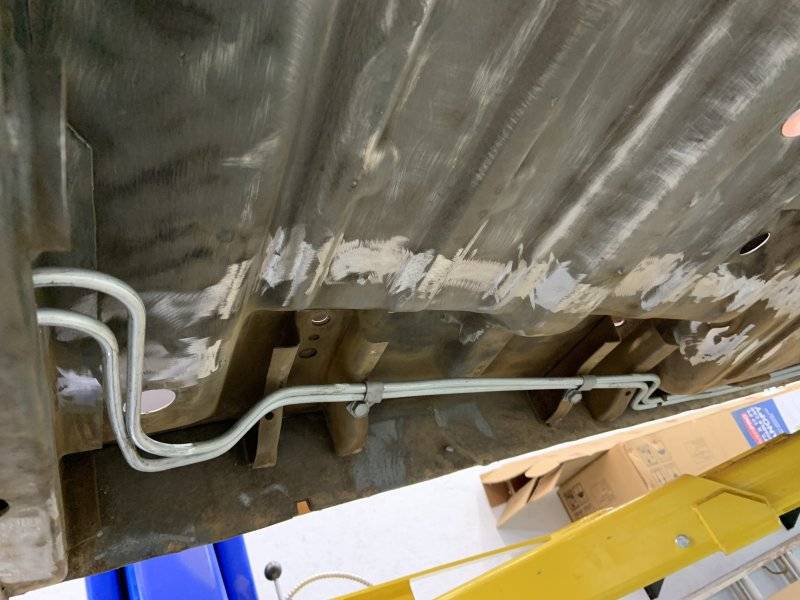

The USCarTool pieces can be frustrating. The fit is not perfect nor is it continuous. So you'll be trying to fill big gaps and will also have numerous additional gaps along the length. Whatever you decide on, keep in mind your e-brake cable needs to pass through and also make provisions for brake and/or fuel lines.

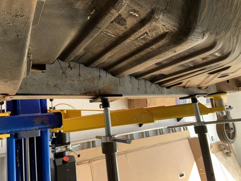

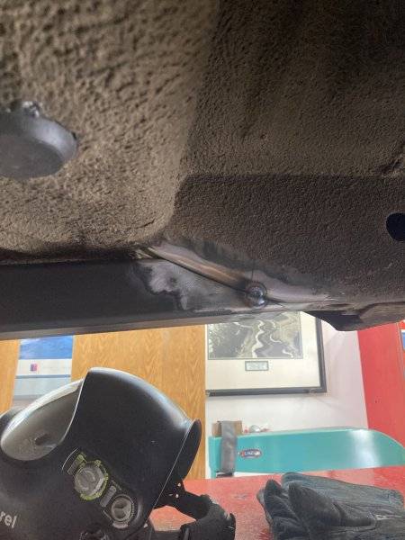

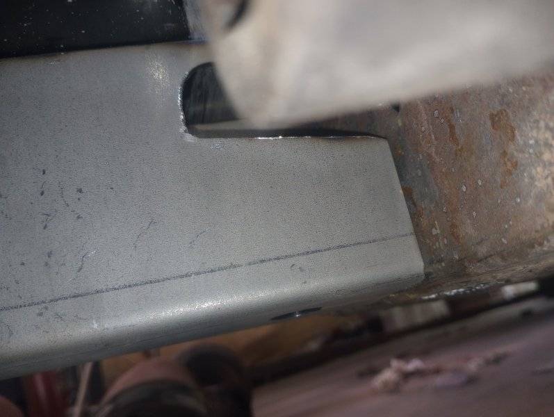

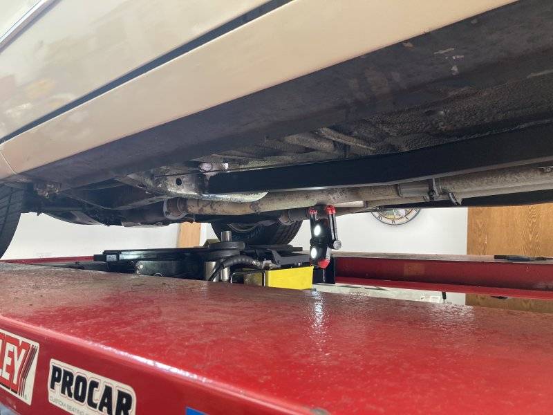

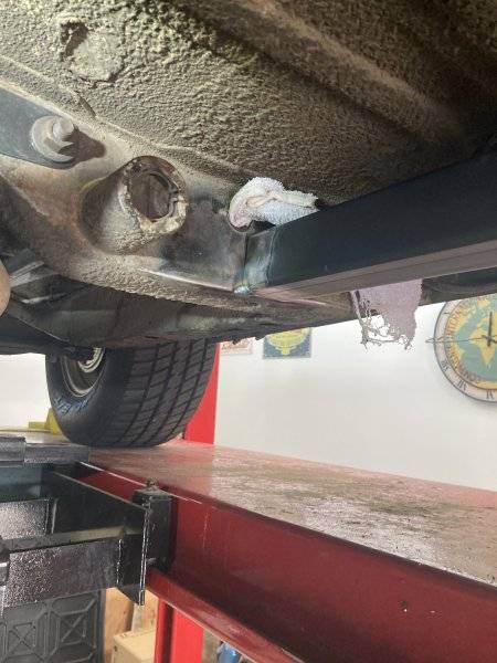

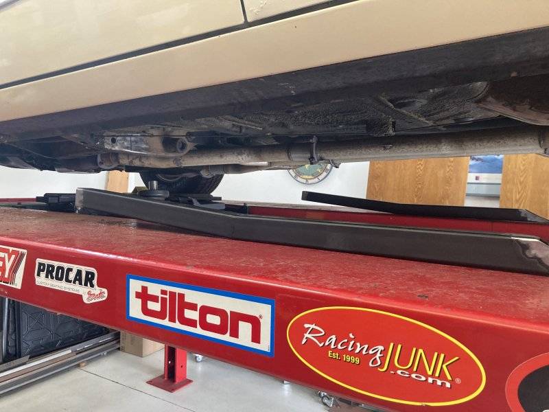

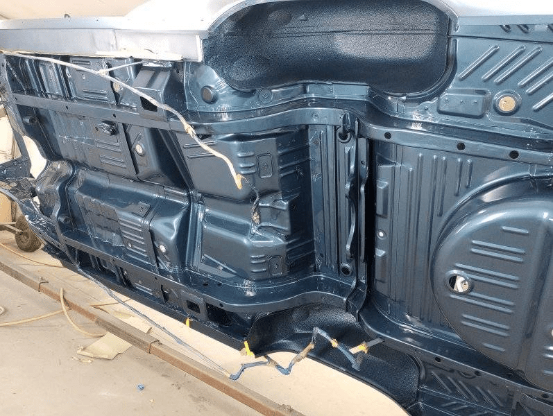

Sure. The first is a mock up and I made notes on the gaps and then trimmed slightly to fit snugly on the floor. Then the floor prepped, and installed.

you can eliminate the front tab if the gap is wide.......makes it tighter to the floor and flush with the front rail
either way.... it's a good look
