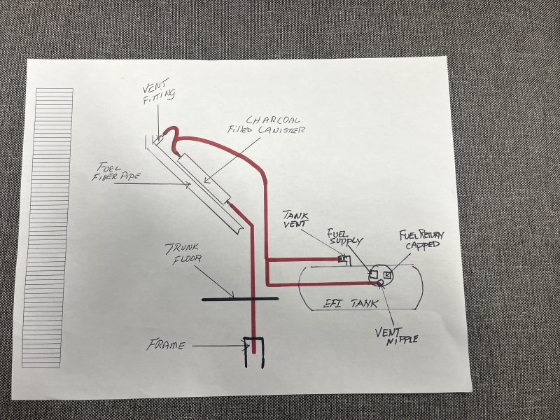

Was thinking of this plan, would it work or any kind of danger?
Tanks Inc says i can cap both the return nipple & vent nipple on the pump mounting plate, but run a hose to rollover valve/vent from the tank nipple, and mount valve above the tank.
Since this is a "Tanks Inc" tank, it probably doesn't have the stock type vent lines installed in it.
So ...
Run the hose from the tank nipple to where the stock tank vent line would attach. Forget the roll-over.
MR gkent…. FYI
Tanks Inc said same thing. Liked my diagram LOL. Instead, he said cap the vent on the fuel pump housing, and just use the “tank vent”…. Run it up to my vapor canister and tee it into existing factory vent….:thumbsup:
