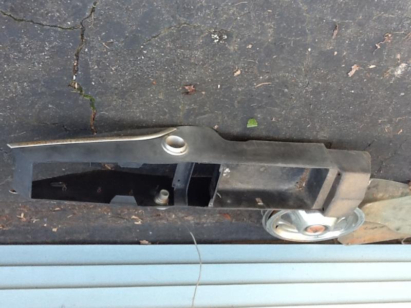

Who knows what car this console goes in
That console is for a 66-70 B-body with an automatic. It will also work in 66-70 C-Bodies.
The console is reproduced new.
Joe
that looks like a overhead console:grin:

Looks like 66-70 B-body console for an automatic car, I think they also used them on C bodies but with a different top plate....
