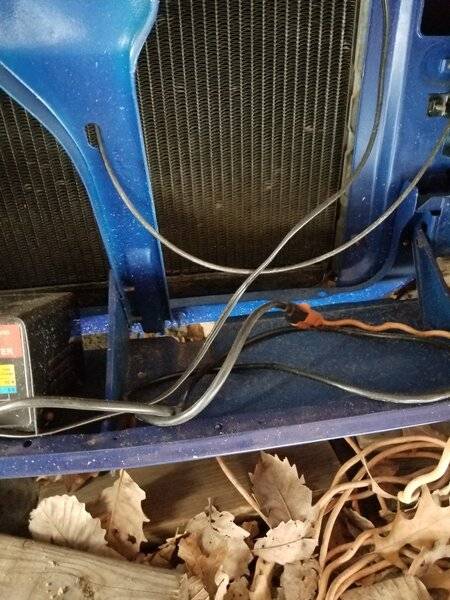

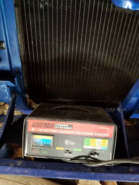

      The fan is too far from the radiator to function properly. It'll be drawing a lot of air from around the radiator and only a small portion through it. You need a fan spacer to get it closer to the radiator (requiring longer bolts too). A shroud would also help a lot. It also looks like you have the 22" radiator, which is common in small block cars without AC and it could work ok if you take care of the fan and the radiator is in decent shape. As it is right now, you could upsize the radiator to a monstrous size and it will still run hot when not moving due to the fan situation.
      Cheapest solution is to add a fan spacer and see what happens. That might do it. Get the fan within and inch of the radiator or so. I'd still add a shroud for extra cooling on hot days. It's good to have reserve capacity when it comes to cooling.
      Next solution: Get a new repro 26 inch radiator, matching repro shroud, and address the fan spacer (my choice)
      Alternatively you could spring for some aftermarket aluminum radiator set-ups, electric fans, etc.
      Good luck with your shoulder.

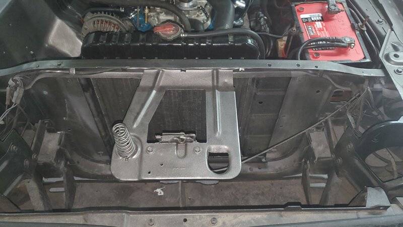

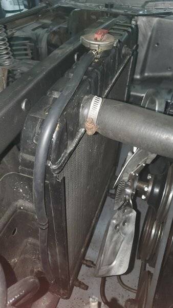

        That radiator doesnt look right: looks too small: both "318" (360 ci build-up to about 390hp now in project) cars that I have the radiators are wider, fins all the way across. See pics; Hope you are not over heating? Is that radiator from a body or is it a 225 radiator?
        Hope your surgery went well & speedy recovery!!

          My 66 383 came with a 22 inch radiator and a fairly small 4 blade fan.
          It doesn't necessarily need a 26 inch radiator. But the core does need to have flow throughout.

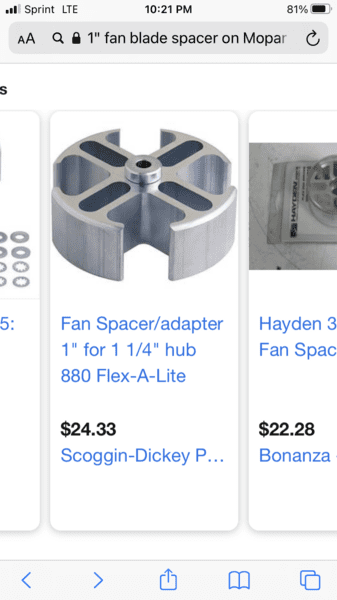

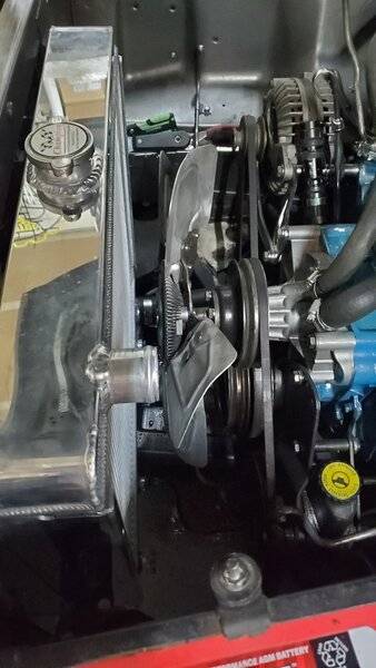

                Thank you all... I appreciate it. I think I have a spacer. If not it's cheap and easy. I bought a larger champion radiator. What is typical space between fan and radiator. So I went on YouTube to clean windows washer Reservoir and nothing. Detergent and bleach did nothing but ruin my black clothes..

                  Ok so with the new radiator I have 1 3/4" between fan and radiator. What is the typical spacing? I put the fan w clutch on there. The old one was all messed up and was just bolted straight to 2" spacer.

                  It might be ok because it is so cool in the PNW. Ran as-is and watch the temps. Defintely a big improvement over what you had! I would still add a shroud too for that occasional hot summer day / stuck in traffic scenario.
