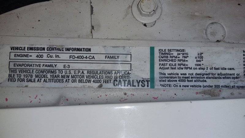

Hello, thanks, but the HEI ist not the Problem it think. I am concerned about the timing curve. Shop manual say to use emission sticker, and sticker say:
