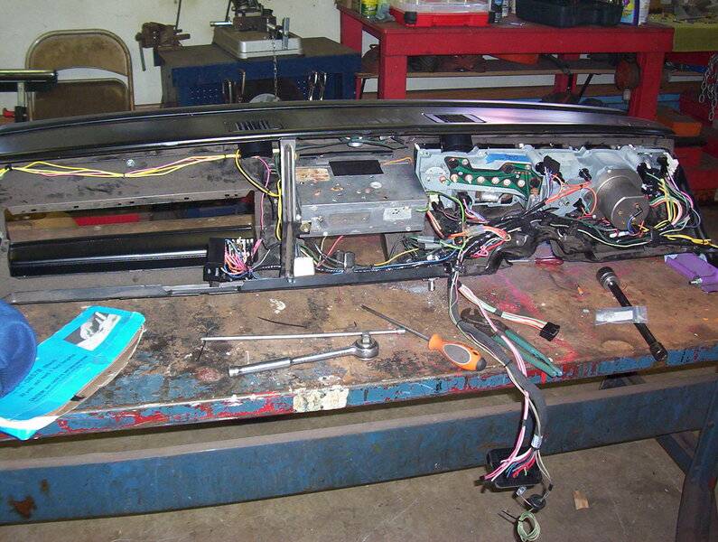

They are very different. You would be better off with a decent Rallye harness to do this. However if the complete dash was out on the bench you would have a better chance of fitting everything. Here is a picture of my 69 Charger Dash on the bench
Thanks much! Dash is out of the car. This should help me. At least i can compare and see how bad it is actually hacked up. Thanks again for the photo

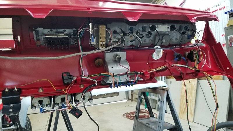

On the bench, it’s a piece of cake. Compare the two diagrams. Add additional wires as necessary. If you want to make it undetectable there are two options. Untape the harness add wiring and retape. Or just add the overlay wiring and attach it to the existing harness. Either method will work without issue. I’ve modified harnesses many times. Made harnesses many times. On race cars I prefer to leave them untaped for quick diagnosis at the track if necessary. Here’s a 64 Polara race car that was just done. The entire harness plugs in at the dash bar in the center.
