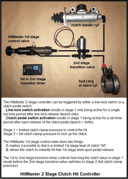

ClutchTamer:
http://clutchtamer.com/
But WAIT! New for hydraulic TB clutches (This I've never seen before, could be an even better way of doing the launch adjustments):
For hydraulic clutches, the HITMASTER!
http://grannys.tripod.com/hitmaster.html
:popcorn2::popcorn2::popcorn2::popcorn2:

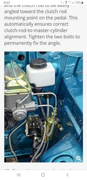

So I got the American Powertrain hydraulic system at a booth they had setup at Cruisin the Coast.
I may get the remote reservoir if I have a problem with space for the attached plastic reservoir.
Any feedback on that? I have manual brakes, and I always will, so is the extra space no brake booster provides a factor or should I get the remote reservoir for other reasons?
:popcorn2:
The mc sits down low by the frame rail at an angle so what you have is a remote reservoir. They include a length of hose to meet the mc. So mount the reservoir where ya like. Also a billet aluminum one is available if ya want some bling.
The unit I saw on display had me confused. It looked like the plastic reservoir was attached to the top of the Wilwood master cylinder. I see in the picture of the one they installed here that the plastic one can also be remote located:
I'll call tomorrow and make sure my i's are dotted, t's crossed. At this point, what's another $100 for the billet remote reservoir? I hate to piss money away, but even if it's less susceptible to heat it may be worth the cost of the aluminum reservoir.
Thanks.
Any reason not to just use the existing clutch rod hole in the firewall? I want to get the new rod at the angle that requires the least amount of force to disengage the clutch.
The 2,900# pressure plate is KILLING my beat up old knee!
That’s where it goes on the firewall, just need to drill a few holes for the bolts. I liked the plastic, see at a glance where the fluid level is.
