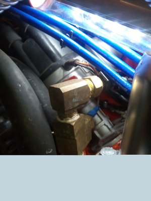

On my EFI setup, I used an extension fitting.
If you have an aftermarket aluminum water pump housing it will have 2 locations. If original cast iron, then you can drill/tap another hole.
