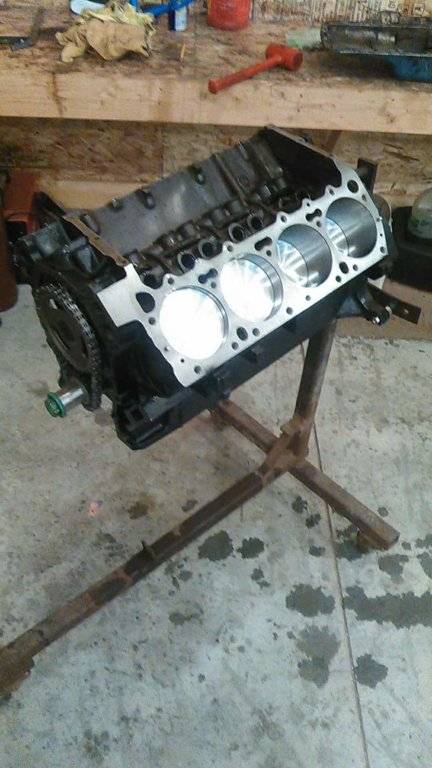

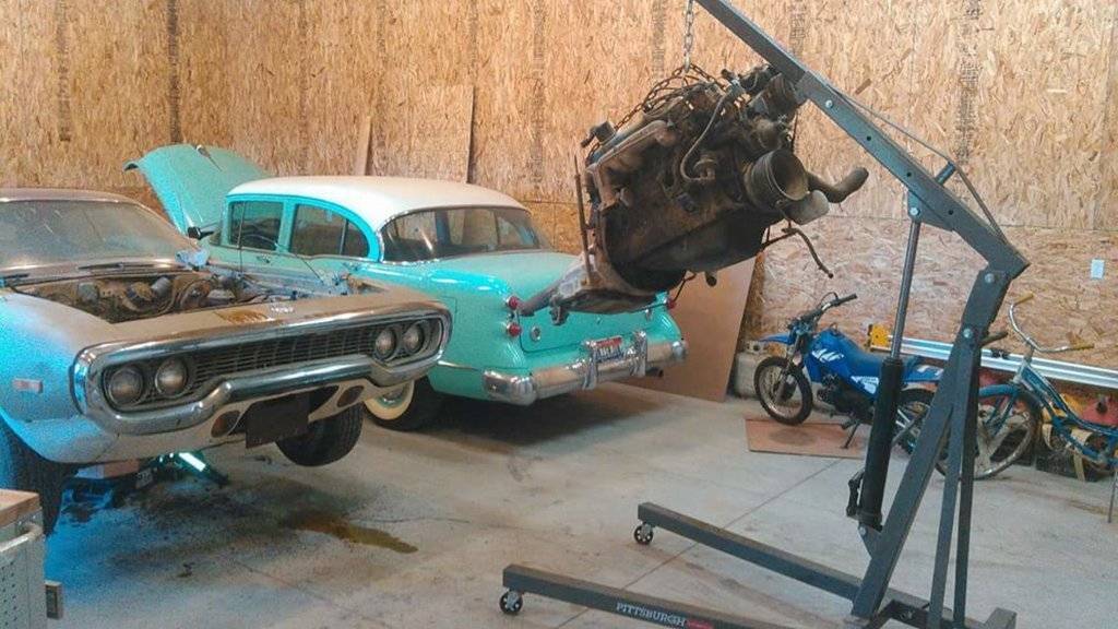

Finally got the shop built so I could get serious. We pulled out the locked up 400 and auto 727. When I tore the motor down it was completely out of oil and had three rods welded to the crank. The block would take a great deal of milling ( like opening up the mains for a 440 crank). I want to get some more knowledge before build a stroker so I found another 400 and tore it down. I had it bored 30 over, milled the top of the block, milled the heads, and intake. Goal was a modest 8:1 comp. Power sealed flat top pistons with an r.v. cam and solid lifters. I may have done it a little backwards by building the motor first. Finally it is topped off with an Edelbrock 750 4 Barrell.

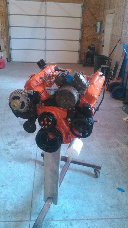

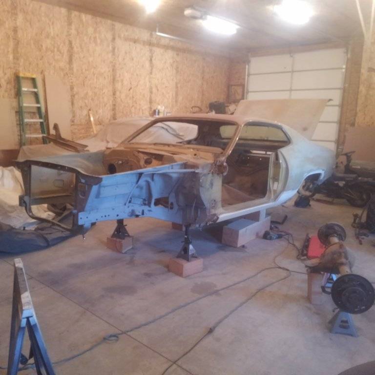

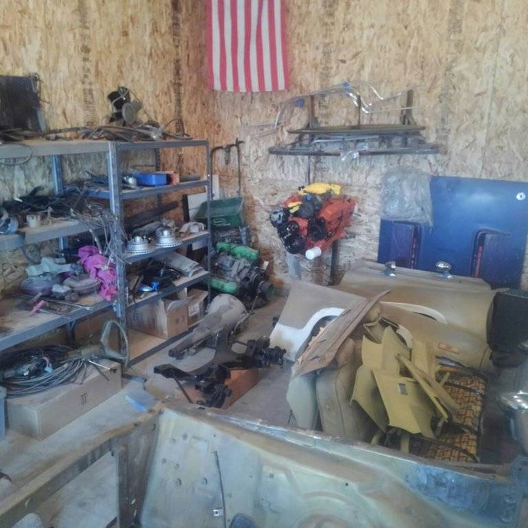

Motor done and bagged, I completely dismantled the satty. Bags and shelves full of parts. I blasted and repainted the k frame, and replaced all the bushings. Yeah everything that I read about the lower control arm bushings was true. That was a struggle.. the front end is now rebuilt, painted and waiting with the motor. Engine compartment is blasted and sprayed in self etch.

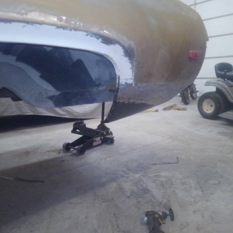

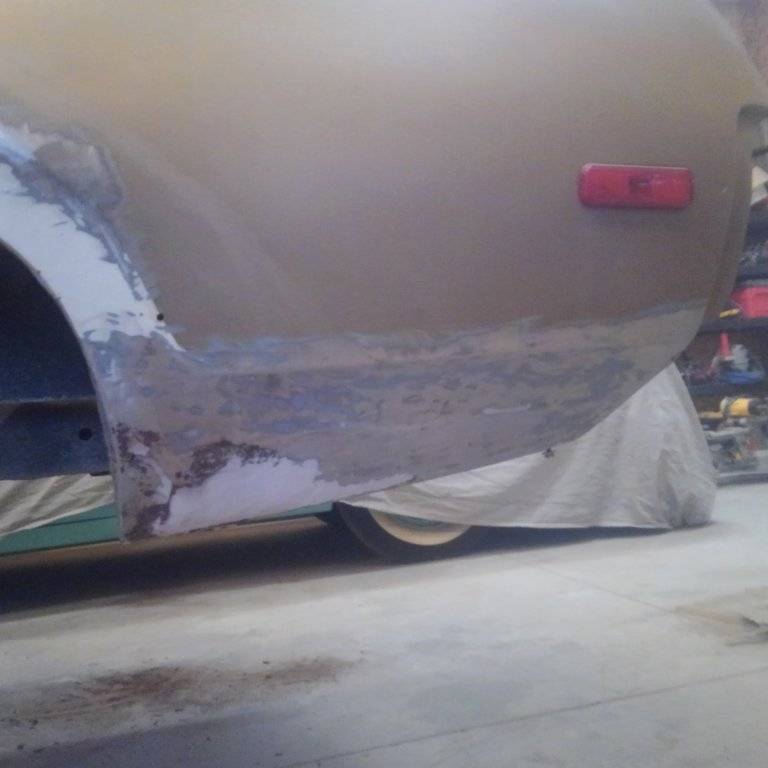

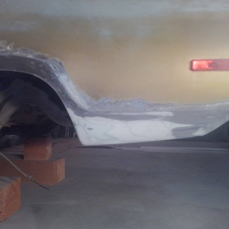

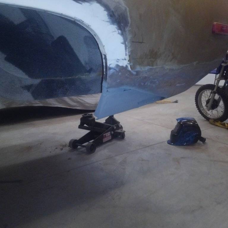

Rear driver's side quarter surgery. I had to tear out remains of a previous attempt that included galvanized coil metal, sheetrock screws, stucco mesh and 3/4" of bondo. The trunk extension was also rusted away along with the panel. Ordered a new patch panel and built a new extension. After some self taught welding lessons I got to work. Not to bad for my first patch panel.

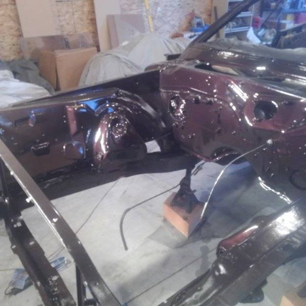

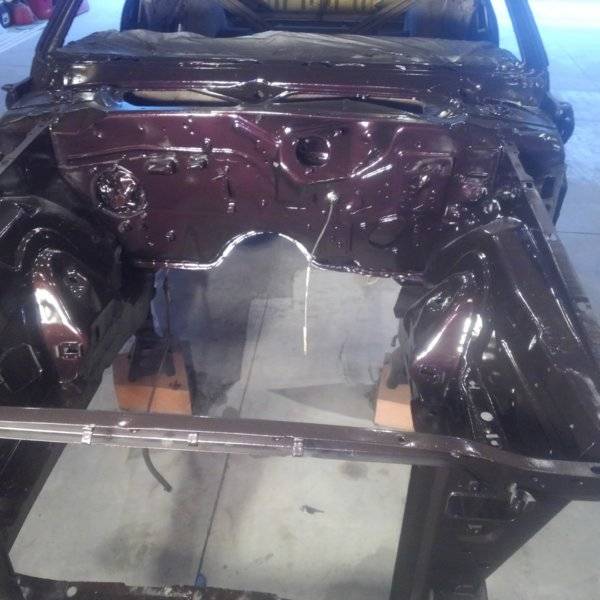

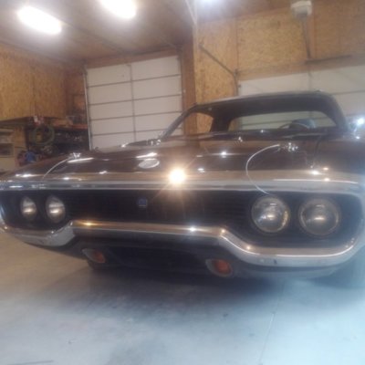

The anticipation to put some color on has been killing me. Shot the engine compartment, firewall and jambs. What do you think about this color?
