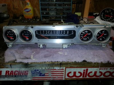

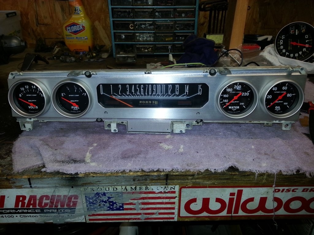

This is what I did to put bigger gauges on my '70 Coronet R/T non- rally dash. The clear plastic speedo lens was ruined on the ends. It looked like someone tried to clean it with sandpaper. I still like the long sweep speedo's, and luckily, that part of it was still good.
