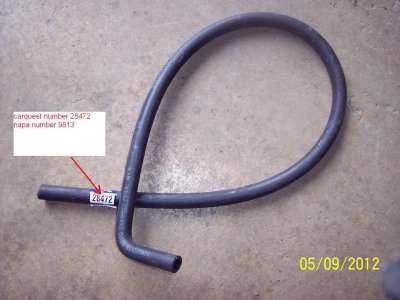

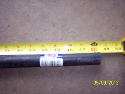

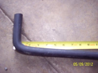

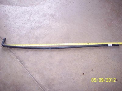

I forgot and don't know if you may need help on real nice replacement hoses.
Here are some pictures.It has a real nice 90 degree and makes a nice job .Trim to fit they fit Dodge trucks.Priced at approx 14-15 dollars.
Jeff
Jeff
Those are nice....what diameter are they?
Hose
Red
They are 5/8".
